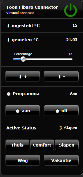

If you have a fibaro Home center II you can also use a virtual device to communicate with toon
- Fibaro toon connector
- fibaro toon.PNG (21.79 KiB) Viewed 29020 times

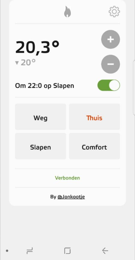

Hai all,
My son Sander was a bit bored and was looking for a project.
The result is an android app that can work with a rooted toon.
Just install the APK file, add the IP adress and you're up and running.
All source files and apk can be found at.
https://github.com/jonkootje/toon-app
Your feedback is welcome
Regards,
Sander & Martin

- Toon app screenshot

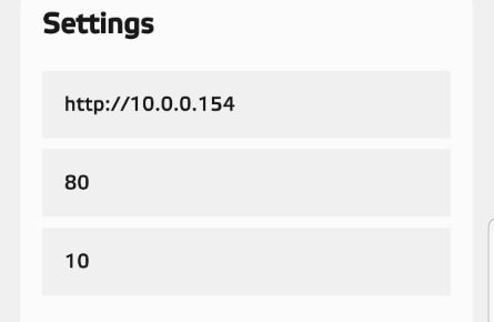

Re: android app TOON
The settings should look like this: http://youripadress
I use it over a VPN to connect to my home network (Not the Toon vpn)
If it can retrieve the status with http://youripadress/happ_thermstat?acti ... mostatInfo it will show "verbonden"
It is working on my galaxy S8 with android 7.0. He used websitetoapk to build it.
- URL settings
- settings.JPG (14.58 KiB) Viewed 28046 times
Marcelr,
The Toon version we have tested on is version: 4.8.25
