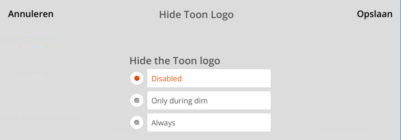

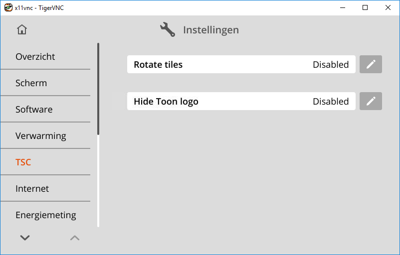

7. the settings screen has a new item: TSC (Toon Software Collective :D )
here you can configure the rotating tiles mod as well as hide the Toon logo.
More mods to come in the future here.....
