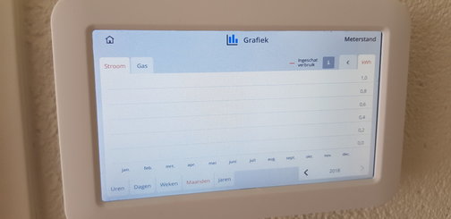

I'm running on 4.15.6 and don't have any month usage displayed for electricity nor gas. Hours, daily, weeks and years are working fine. Also I'm seeing "ingeschat verbruik" in the month overview. Any ideas to fix this?

Same issue here, only missing the bars in the months-view.
Hours, days, weeks and years work, but not months.
No smart-meter here, just analog sensors.
I tried changing the endDate from -1 to 1627485995 a suggested here, but to no avail.
viewtopic.php?f=104&t=12165&p=87517&hilit=month#p87495
Already disabled other_provider_gas and _elec in global settings, but that didn't help. Not after gui restart or reboot.
It seems that the Month-usage originates from another datasource (not RRD)
                // create arguments for rrd request based on currently selected type/period/dateTime/usage/costs
                function requestData() {
                        // month data are not requested from rrd, there is an individual dataset, the data are stored in app, don't use for heating beat
                        if (bottomTabBar.currentIndex === 3 && topLeftTabBarControlGroup.currentControlId !== 3) {
                                p.populateBarGraphMonth();
                                return;
Any hints?
