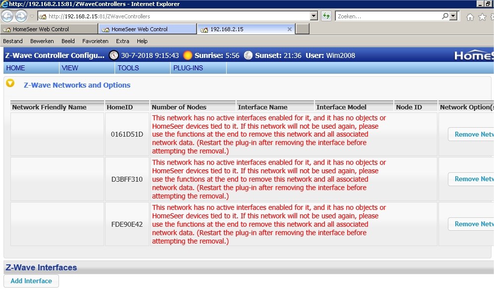

I have a pc with HS3 and windows 7. ALso I run on HS3 with zwave included with Z-stick S2 and Z-Stick gen5 for a few years.
Zwaves works al fine till last month.
Begin july the software of homeseer gives several errors. After restart the pc the error was away. Last week every day came the error again till the last weekend. After restart the error is again on HS3.
The error says: wrong port is detected. Both Z-sticks worked on different com-ports on my machine.
But now after a few days in HS3 zwave controller management I don't see any Z-stick connection in HS3.
In the z-wave networks and options are 3 HomeID given. Nne of the networks I can remove.
See also picture z-wave controller config.
How can I see what is wrong with my z-wave? And how can I solve that?
Wim
Errors in zwave controller and config
- z-wave controller config.jpg (158.34 KiB) Viewed 13321 times

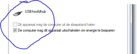

perhaps windows is losing the stick,
or
disable all powersave things for all youre usb devices
or

well, if windows loses the usb sticks, possible set it to sleep then homeseer can't find the sticks.
you can try installin hs3 (demo) on another pc and test if the sticks are working.
if it doesn't work the sticks are history, if it does work it's hs3 on youre machine end/or windows
either case, set all powersavings off for all usb devices.

I have controlled the powersavings of the USB. But were already disabled.
