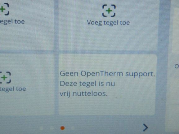

My Toon is installed on my Intergas HRE ketel with the ketelmodule on opentherm. The heating works fine and i can see the status CV / WW. But when i select the tile with "ketelstatus" is see the message "geen opentherm support". Also there is no incoming information of modulation level, boilertemperature etc in Domoticz. Is there a setting wrong? Firmware is 4.18.8, ketelmodule 37.

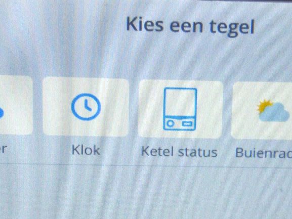

On a empty tyle i can select under algemeen the tyle ketelstatus. It can show modulation level etc

Tile whit selected ketelstatus
Ketelstatus to select
Here some screenshots. Is this the original app? Can show the boilerstatus app from de Toonstore some information on a tile?

Posts: 1918
Re: Opentherm support
Ok, got it.
Somehow you have the very old legacy version 0.1 of the boilerstatus app installed, this one is not supported anymore.
Can you remove the boilerstatus app from the ToonStore and after that manually delete all 'boilerstatus*' folders you have left in /qmf/qml/apps ?
When completed install the new boilerstatus app again via ToonStore and you should be fine with a nice tile showing you the available boiler parameters.
The fact that version 0.1 was installed blocked a proper installation of 1.0.4 because the symlink to the 1.0.4 folder could not be created.
Basically you always kept using version 0.1 in the boilerstatus folder instead the one in the boilerstatus-1.0.4 folder.
Anyway, have fun now... :-)
