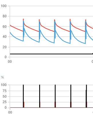

Is it possible on the toon to set the warmwater off for the night?
i don't need it at night so i like to turn that off
you can see on the picture that the cv boiler is burning the whole night to get the water on temperature

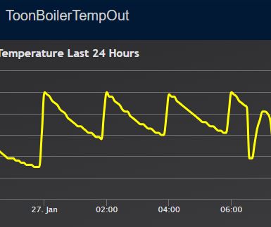

I've enbaled this setting and tested it:
When preheat is switched to on in the GUI, the small hot water boiler of my opentherm boiler is indeed kept heated; during nighttime the boiler runs every 2 hours for a few minutes.
When I switch off this setting, it does not preheat.
Would be actually nice if this setting switches automatically depending on the state of the thermostat. Not sure what the right way of doing this.
