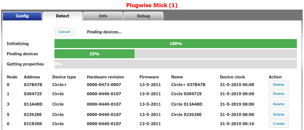

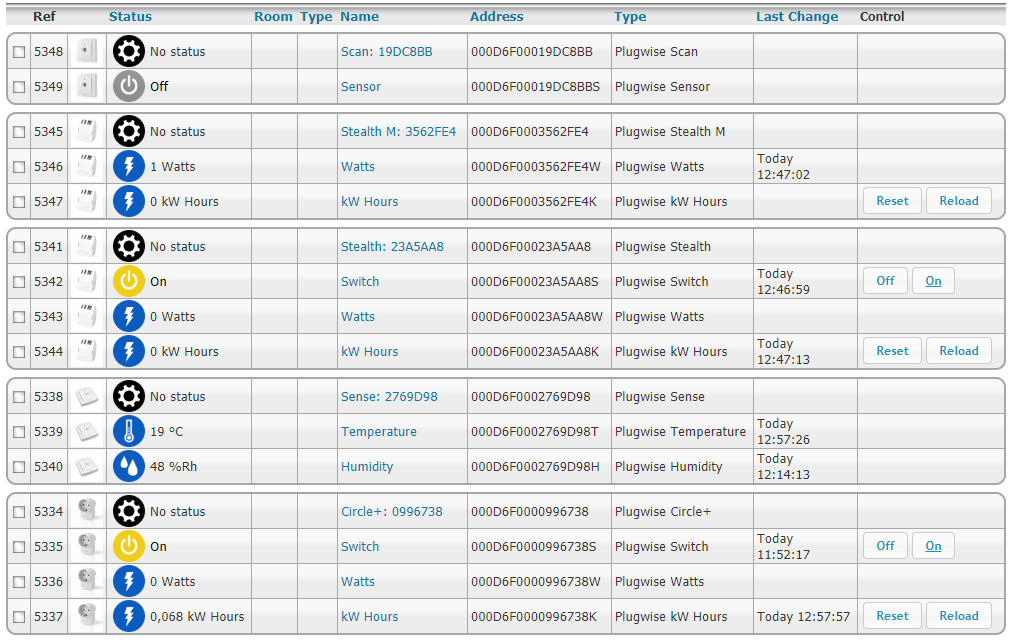

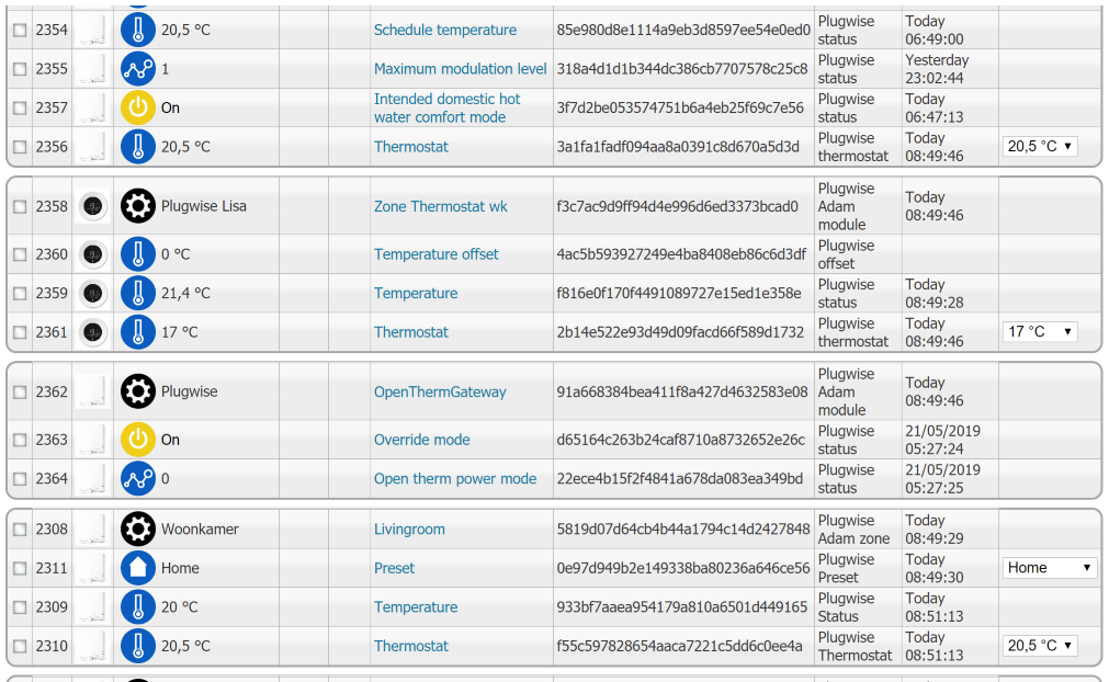

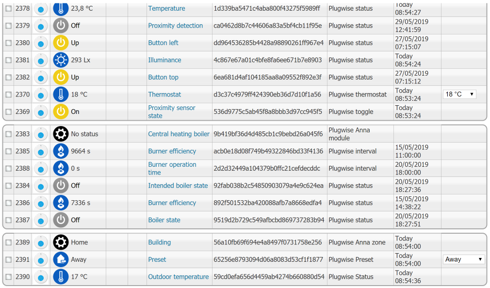

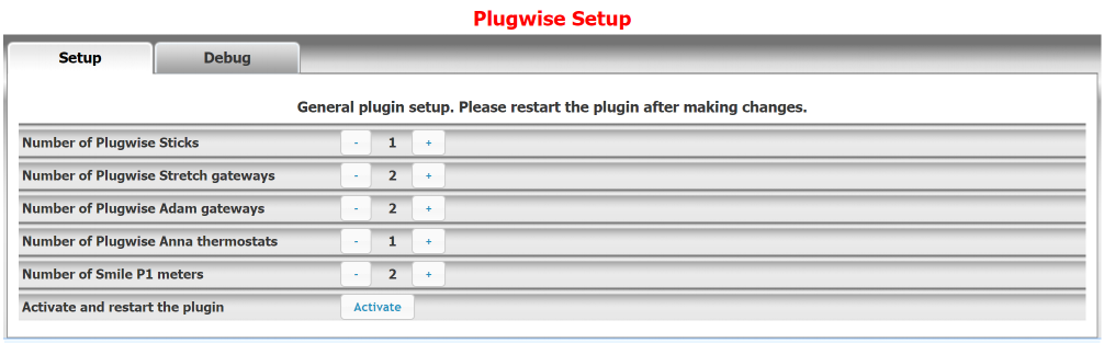

A few screenshots:
Setup with unlimited gateway support
Stick device detection
Stick setup.PNG (68.39 KiB) Viewed 18584 times
Stick devices
Stick devices
Anna devices
Anna devices
Adam with Lisa
Adam with Lisa
