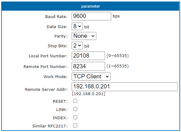

I have a Nodo v2.3 Opentherm Gateway. Originally I was using it with the Wemos D1 Mini to make a wi-fi connection. However I was suffering from wi-fi dropouts, so I replaced the Wemos with a USR TCP232. But unfortunately when I try to connect the 'otmonitor' app to to gateway via ethernet I get 'connection refused'. I can connect otmonitor to the gateway via USB so I can confirm that the gateway is working. And I can also connect to the USR TCP232 web configuration page via ethernet, so I can confirm that it is also working. However when I try to connect otmonitor to the gateway via ethernet, I get 'connecting...' and then 'connection refused'. My guess is (as was yours) that there is something wrong with the configuration of the USR TCP232 serial port (shown in the screenshot below). => Any suggestions?

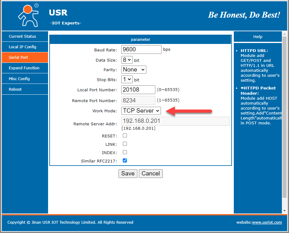

Yesterday I posted a follow on question, but in the meantime I have found the solution myself. The correct Serial Port Settings for the USR-TCP232 are as shown in the attached image. Important is to set it for TCP Server mode (and not TCP Client mode)!
