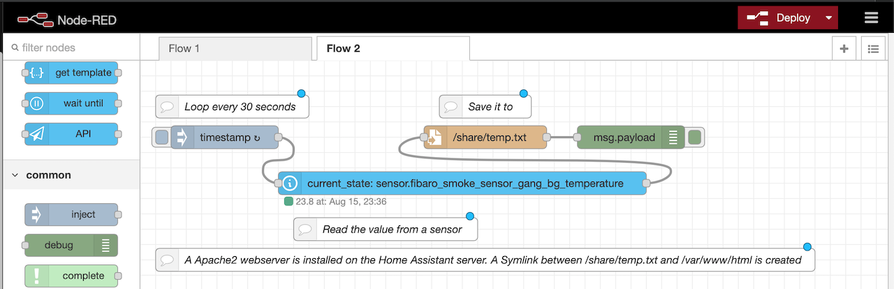

I have a externat temperature sensor in Home Assistant.
Via Node_Red I've managed to write the temperature in a txt file.
I've installed apache2 webserver and used a symlink to the txt file.
On Toon I've created a simpel script that wil download the txt file via wget with a loop every 25 seconds.

The Node Red script on Home Assistant works
The webserver works
The wget download script works
Toon reads the contents of the text file.
Only one thing that I need to solve is to automatically start the script at boot.
For the info:
Node Red see attached file.
Node Red
Node Red
Schermafbeelding 2020-08-15 om 23.37.11.png (172.94 KiB) Viewed 14999 times
