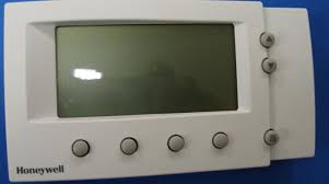

Is Opentherm gateway compatible with Honeywell CR11011 thermostat :
pobrany plik.jpg (4.63 KiB) Viewed 2561 times
I'm using Opentherm gateway with great success with AD-289 iSense thermostat and now I'm think of expanding it on to the second Honeywell heating system I have in a second building.
Anyone tried CR11011 ?

It looks a lot like the Termet CR 11011 https://www.termet.com.pl/pl/produkt/cr-11011/17 which supports OT and is listed in the Thermostat matrix http://otgw.tclcode.com/matrix.cgi. So I guess it does. Check the manual or text near the wire connection at the back, there should be an OT reference/logo somewhere.

Great News !
Termet is a polish company making their products strongly based on Honeywell elements so for sure these thermstats are exactly the same.
