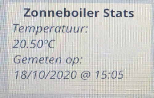

I've created an app for reading the temperature of my solar boiler. It makes use of a sensor connected to a Raspberry Pi (seperate project) as the solar boiler does not have its own temperature sensor which can be read. An interval can be set on how often the temperature data has to be refreshed on the Toon.

On the Toon a tile can be added which gives the following information:
Meting zonneboilerStat.jpg (69.69 KiB) Viewed 11000 times
