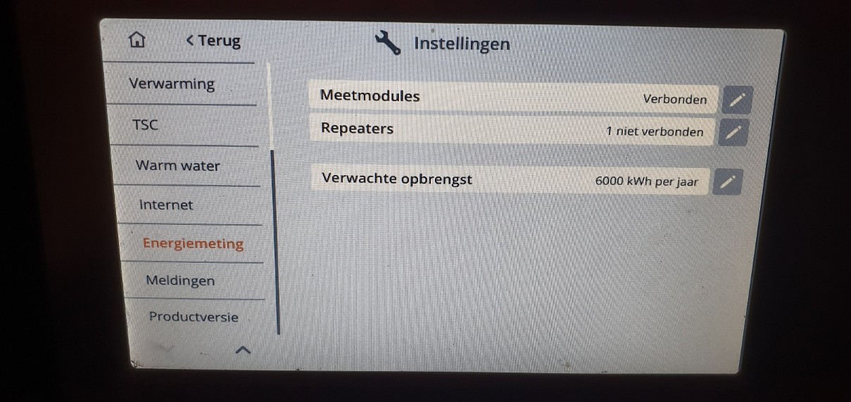

Reapeters dont give you a tab on the left. You can remove them:
Menu >> instellingen >> Energiemeting >> tab on the potlood after Repeaters >> Tab Geavanceerd >> Tab Verwijderen after Reapeters.
This will delete all you Repeaters in Toon.

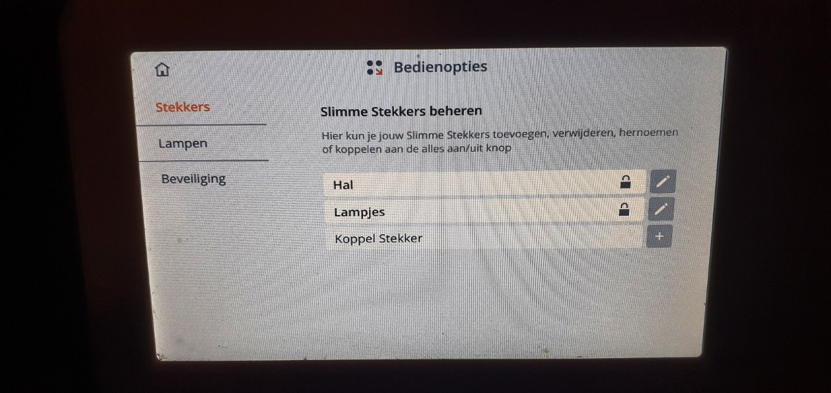

I see what's going wrong .. Please follow the steps below:
Step 1:
Look at the red arrow, which you have to press!
Step 2:
Step 3:
Step 4:

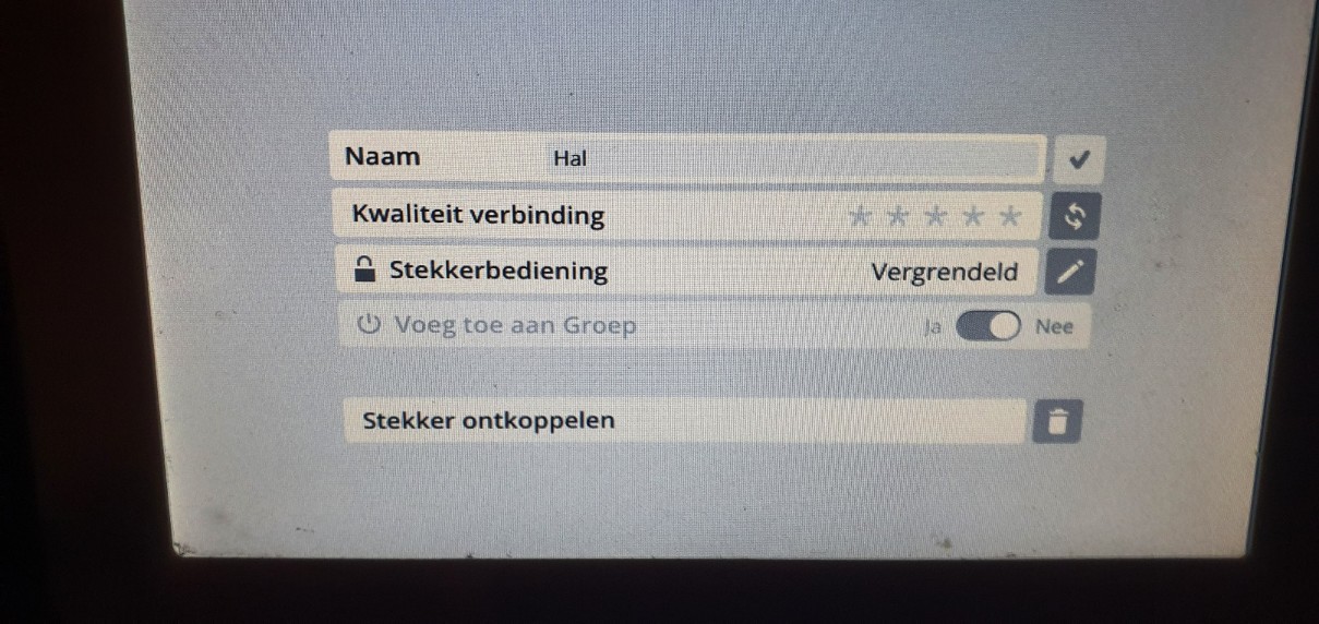

If you want to remove smart plugs ? Then tab on the press the trash behind it!

Thanks, repeater is gone now.
The trash can behind the smart switch still wants me to press the button three times, so that's not possible.

Ahh, solved.
When you don't press the button and just wait for the rotation to end it gives you the remove option.
Now that button on the left is gone, exactly like I wanted
