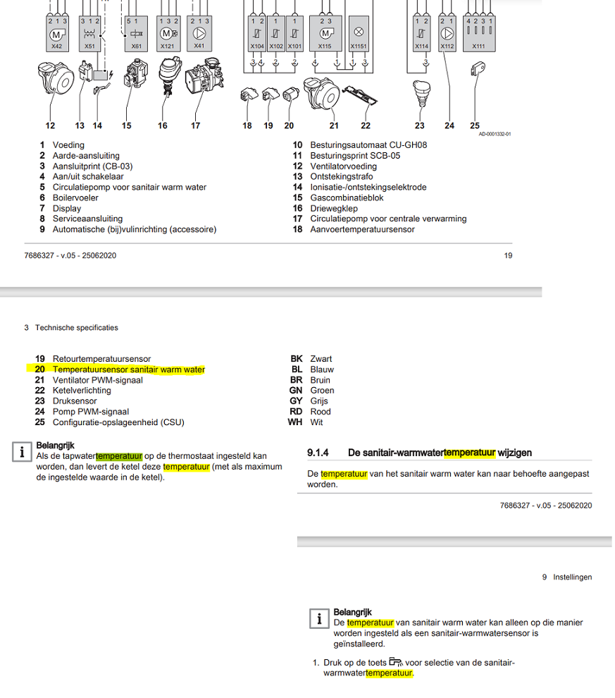

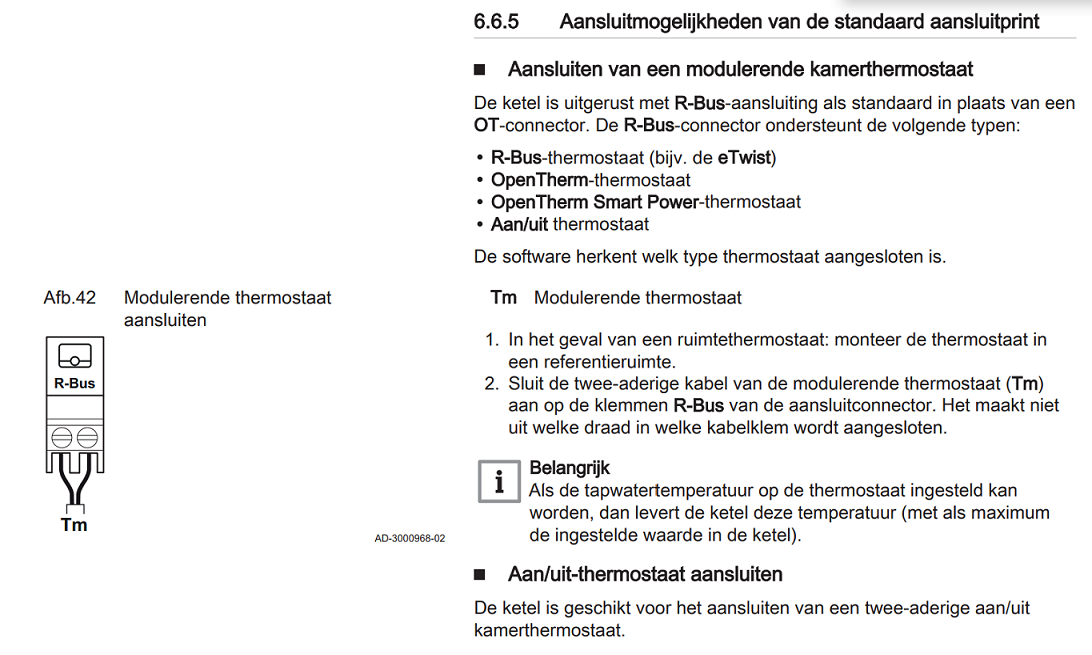

The Boiler manual is mentioning this sensor indeed. And I found a small remark as well.
As this is the TOP range model (Calenta ACE) I would expect it to be available, but with your help I now have a service ticket open with the supplier to see why this could be missing.
In addition I found. (simple Honeywell Round is not able to set this option, that is for sure).
