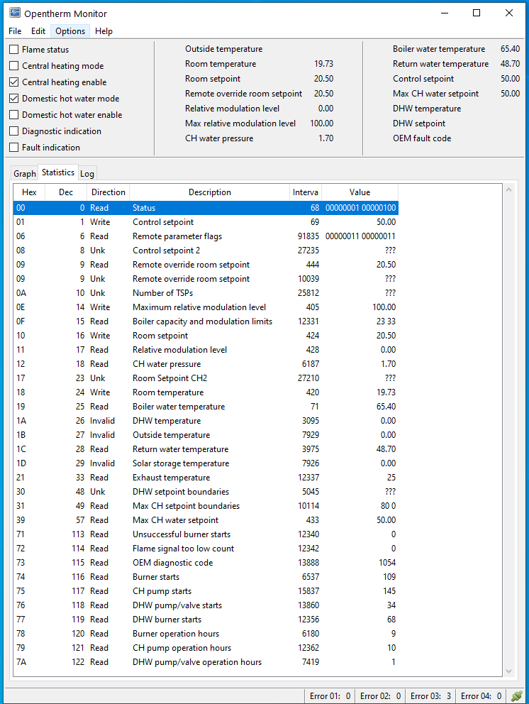

Just Kicked out the OLD AGPO Ferroli due to heating chamber-seal issue.
All wiring melted bleah..
Quite an investment, replaced it with Remeha Calenta ACE 40L. Now running with Domoticz / OTMONITOR 5 and still FW 4.2.5
Did not find a specific topic regarding this Boiler type and my Honeywell round modulation thermostat so created this specific topic.
With help of this forum and Excel I managed to extract the following datapoints.
Unfortunately DHW Setpoint and DHW Temperature remain unknown.
Anyone else being able to have these filled with the ACE model ?

If you feel a screen shot has added value, make sure it is readable. You have reduced the font to just a few pixels and then made things even worse by saving it as jpeg, an image format unfit for this type of screen shots: http://lbrandy.com/blog/2008/10/my-firs ... -webcomic/
I for one am not going to strain my eyes to try and make out the reading on your image.
