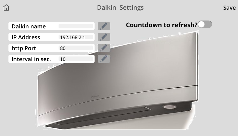

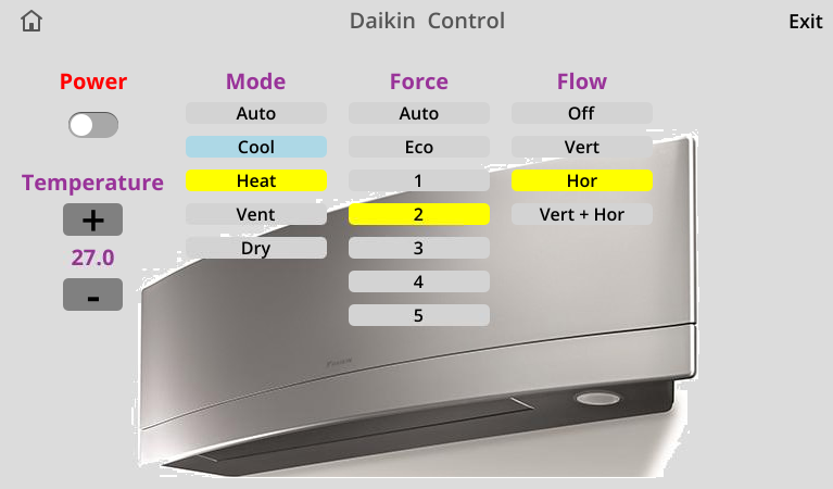

I am new to all this but was able to create a nice app to control my Daikin airco. See screenshots below.
Now I would like to submit it but do not know how...

Settings screen :
Settings
Settings

Controls screen :
The controls on my daikin app

Also, the app isn't nice on a toon2 (other screen dimensions). If you finish the product I can hopefully extend to to a toon 2 compatible one.
Last thing, can you remove the system tray icon (and file) and replace that with a 'settings' button in the screen page? There is no need to put a system tray icon for only settings.

In a next version I will remove the systray icon and put a little settings button on the control screen.

Can you give me advice on what to do for formatting of text, margins, sizes etc ?
I have seen things like 'topMargin: isNxt ? 19 : 15' and 'pixelSize: isNxt ? 25 : 20' but I am not sure how to use these and what to do for other "things" so it looks nice on both Toon 1 and Toon 2.

To make it toon2 compatible you need indeed the isNxt boolean value. So if isNxt is true, then the first value is used as width and otherwise the other one (isNxt = toon2). But to know the values you really need a toon2. I will be happy to change everything for toon2's, no problem. Just focus on your toon1 for now :)

- Control screen : replace 'Monitor All' by 'Exit' in case of 1 airco ( Thanks Arie )
- Control Screen : input validation for temperature limits
- Control Screen : a background image per airco (defaults available in '/qmf/qml/apps/daikin/drawables/')
- Settings Screen: input validation for IP Address, TCP Port, Number of airco's and Refresh Interval
