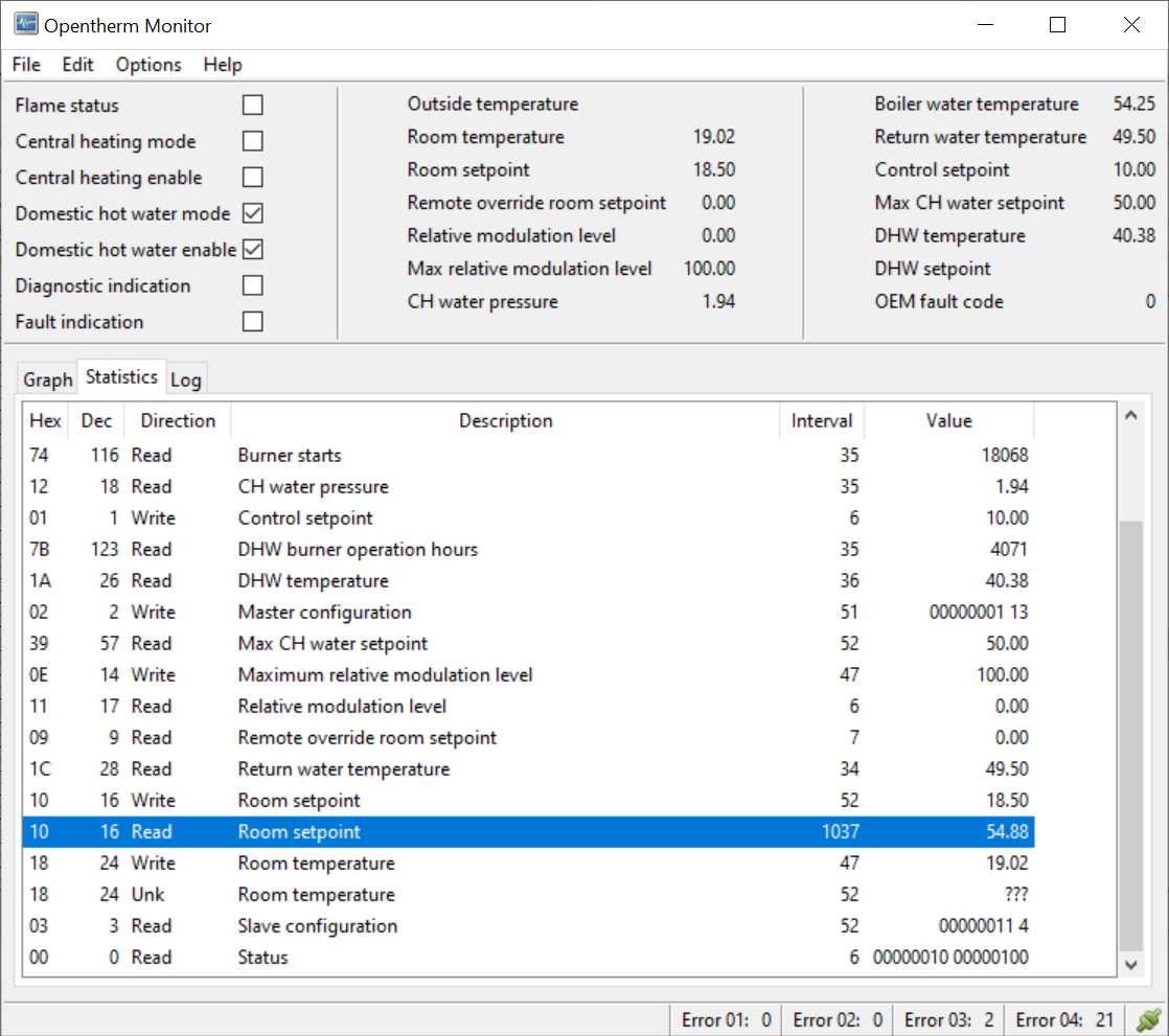

I am happily using the OTGW together with a Honeywell Round Connected Modulation thermostat and Atag I series 36EC boiler for a number of years now, still using 4.2.5 FW (slightly modified to use the SB feature to change the control setpoint). I use Domoticz to monitor the setup.
It is all working fine, but since the beginning I noticed that a few times per day the Room setpoint as shown in Domoticz shows a glitch where instead of the Room Setpoint, the Return water temperature is reported (for one sample).
I never paid much attention to it, but recently while playing with OTmonitor for another reason, I happened to capture such an event in the log (I noticed it in the Statistics tab, very useful!). Apparently, what happens is that the OTGW requests the Return water temperature, and the boiler appears to respond with a Read-Ack Room setpoint. The exchanged value is the Return Water Temperature. From this last part I deduce that the boiler has correctly received the initial request.
So no big deal, as the actual Room Setpoint is not modified.
I am just wondering, would this glitch be due to the boiler messing up the return message (2 bits flipped?), or is the OTGW misinterpreting the (presumedly correct) message? I find it somewhat remarkable that it only (be it very rarely) seems to happen on the Read-Data Return water temperature request, which is made by OTGW (the thermostat itself does not request this). I don't see it happening on other configured requests (e.g. CH water pressure).
A longer log shows a few dozen Error04 (only faulty boiler messages) and a few Error03 per hour but the thermostat does not seem to be bothered by it, and just repeats its requests when this happens.
