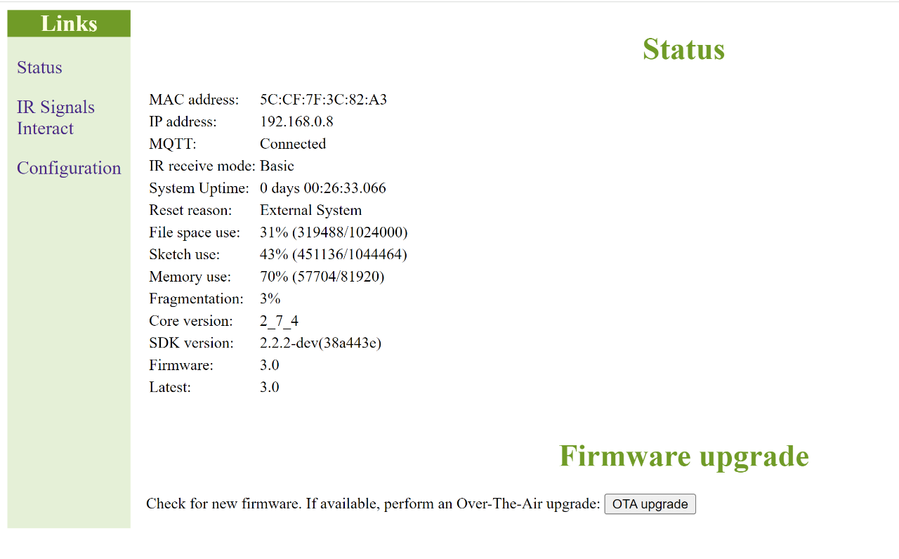

I have a ESPIRP WiFi Infrarood zender/ontvanger from Nodo-Shop.
Receiving and transmitting signals from and to my TV set and remote are working fine from the web interface.
Receiving from the TV remote by MQTT is also working fine.
Transmitting to the TV by MQTT wil not work even after following instructions on https://espirp.tclcode.com/index.html
Please supply further instructions how to get it working.
See pictures enclosed for some information of the settings used.
With regards
