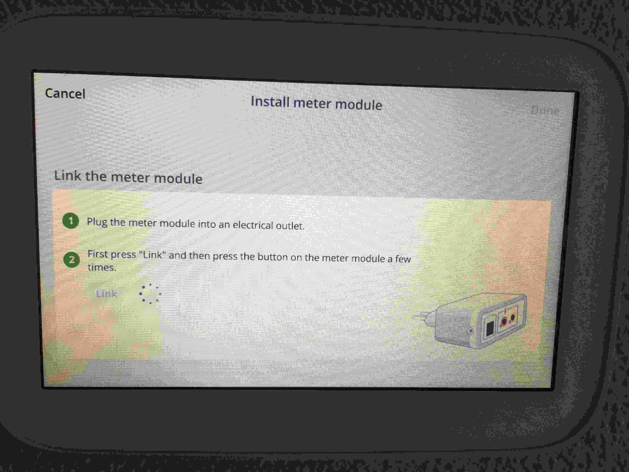

I'm new to toon and to toon rooted. Today I rooted my toon and everything goes well, the only problem is that I got an B00 error. I tried to reconnect my meter adapter but didn't work. Eventually I removed it and tried to binding again but doesn't work, always show a loading image. You can see in the images link.
Notice: before rooted it was working.
The url http://toom_ip/hdrv_zwave?action=getDevices.json shows:
{"dev_settings_device": {"uuid": "c76d74ed-6cbe-478f-a430-0d1531082834", "name": "settings_device", "internalAddress": "settings_device", "type": "settings_device"}}
Is there a way to see the logs?
Is there a way to fix? Should I reinstall or downgrade my version.

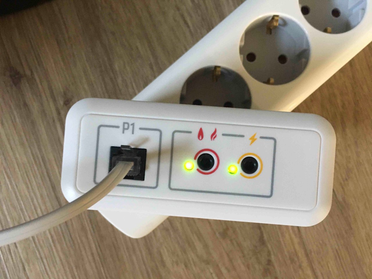

did you restore (herstellen) the meteradapter before you trie to reconnect?

I need to press the button of the adapter for 10 seconds to reboot again and get it connect to toon. Didn't know that.
