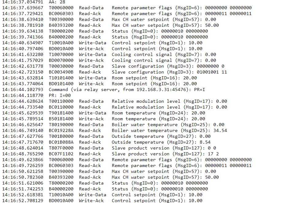

I made a Capability log and during this proces some features where found
with capibilitylog.png (58.9 KiB) Viewed 9698 times
I did this on a windows machine

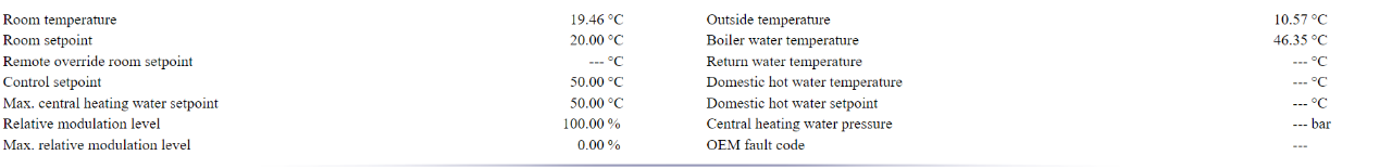

But the otwg is attached to a raspberry
And then I'm missing some features
aan de raspberry.png (62.77 KiB) Viewed 9698 times
So how can I get the return temperature, boiler temperature and water pressure?

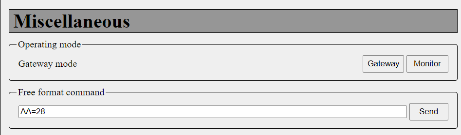

I put the commands in the Miscellaneous screen and klicked on send
2024-03-23 14_16_02-OTMonitor configuration.png (22.04 KiB) Viewed 9652 times
Nothing is chanching en when I look in the messages log I can't see that command is getting some infomation

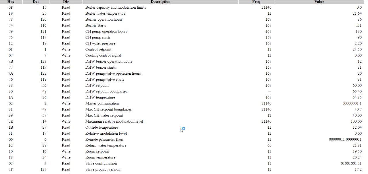

Success, after entering DA.. a few times, I got NF.
2024-03-24 16_07_19-192.168.3.92_8880_messages.html.png (3.79 KiB) Viewed 9583 times
I've re-entered all the values and now I'll just wait for a response or do I need to do something else?

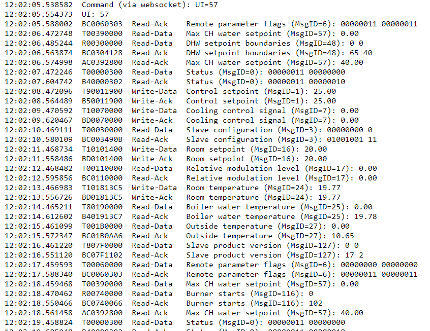

I have set UI=57 because this value never changes and I don't need to know it.
To my surprise, it just comes back. Am I doing something wrong?

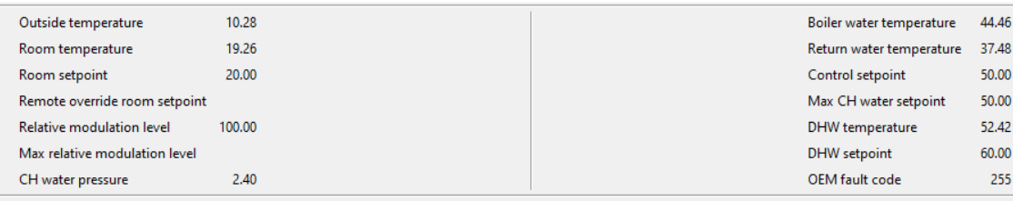

It's just a matter of patience.
2024-03-28 17_10_17-Opentherm Gateway Status Summary.png (31.37 KiB) Viewed 9453 times
I now have all the values I want.

gjaa wrote: Wed Mar 27, 2024 1:07 pm I have set UI=57 because this value never changes and I don't need to know it.
The UI=57 command is doing exactly what it is supposed to do. First occurrence:
12:02:06.472748  T00390000  Read-Data  Max CH water setpoint (MsgID=57): 0.00
12:02:06.485244  R00300000  Read-Data  DHW setpoint boundaries (MsgID=48): 0 0
12:02:06.563874  BC0304128  Read-Ack   DHW setpoint boundaries (MsgID=48): 65 40
12:02:06.574998  AC0392800  Read-Ack   Max CH water setpoint (MsgID=57): 40.00
So, the OTGW receives a Read-Data request for MsgID 57 from the thermostat. It then sends a Read-Data request for MsgID 48 to the boiler instead. After it receives the information for MsgID 48 from the boiler, it returns a response for the information the thermostat requested (MsgID 57) to the thermostat. The Max CH water setpoint happens to be one of the few things that the OTGW keeps track of. So instead of returning Unk-DataID, it returns the value it has stored.
Second occurrence:
12:02:18.459468  T00390000  Read-Data  Max CH water setpoint (MsgID=57): 0.00
12:02:18.470462  R00740000  Read-Data  Burner starts (MsgID=116): 0
12:02:18.550466  B60740066  Read-Ack   Burner starts (MsgID=116): 102
12:02:18.561458  160192800  Read-Ack   Max CH water setpoint (MsgID=57): 40.00
This time the OTGW obtains MsgID 116 from the boiler; the next one on the list of alternatives.
You may not need to know the Max CH water setpoint, but this value is used by the thermostat to properly control the boiler. After a reset, the OTGW will pick up the value it has stored in EEPROM, or a default of 90. The EEPROM value is only updated when you manually set a Max CH water setpoint using the SH command. As a result, the thermostat and boiler may start to get different ideas about the Max CH water setpoint, which could lead to less than optimal temperature control. I would therefor not interfere with MsgID 57. Why don't you just use MsgIDs 16 and/or 24 as I initially suggested?
