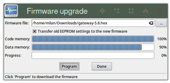

When trying to upgrade the firmware on my gateway through otmonitor I'm running into the following:
Using the GUI, I can load the file, but as soon as I press "Program" the application stops responding. The only output on the console is this one line when loading the file:

When I click "Program", the button remains pushed in (see screenshot) and the entire GUI becomes unresponsive. I can only close the application with ctrl-c on the command line (or with `kill` I guess, but I haven't tried that). This behavior persists in the latest version from github.
