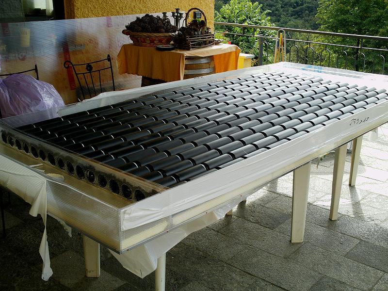

DIY solar panels producing hot air (2)
Post by drmacchi »
Hi my friends, i did this topic here for a commercial panel.
Today after some DIY days i want to present you my own panel , made with alluminio , beer cans and polycarbonate .
Weight is <8 kgs !

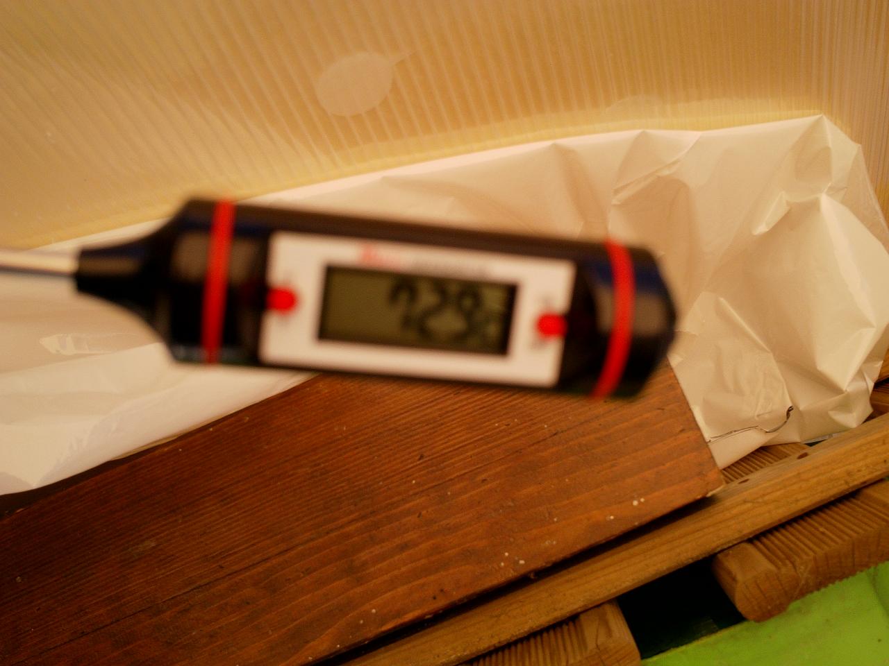

My temp. measure of today : windy, full sunshine (PANEL IS NOT YET FINISHED , lack of lateral isolation and exit pipe is not isolated and connected with tape.... it's just to test :D )
outside air temp °C panel outflow air temp °C
17,6 72,9
18,8 75,4

Noel
Posts: 1887
Re: solar panels producing hot air
Post by Noel »
Looks like a fun project!
What do you us to suck/blow the air, or does the temperature difference do this by itself?
drmacchi
Posts: 827
Location: Italy
Post by drmacchi »
12 cm pc fan , that "makes" 80 CFM = 135,93 m3/h
fan is , for today powered by a 12v psu, but i have a ready to use photovoltaic panel (10watt) to mount aside the air-panel
Noel
Posts: 1887
Post by Noel »
I'm definitely going to have a go at this project (small version 1st)
What are you using as a 'lens' ?
drmacchi
Posts: 827
Location: Italy
Post by drmacchi »
i spent a week on deciding which panel (front vs. sun i mean) , you know i'm a chemist , so i gave a look at many different panel and studied their most important features like light transmission, heat block (once inside the structure), uv-resistant , moisture absence , cells size and numbers (every pannel has many small internal cells), weather resistance ect etc. and PRICE !
the best, is (at the moment):
LEXAN THERMOCLEAR UV RESISTANT .
Please note thermoclear , because there are many many different types , thermoclear is the good one for solar panels
The problem of this first DIY is the chassis : here the panel are glued and then blocked using alluminium angle-profilates , the best would be to find a modular system (alluminium) where you simply insert the panel in the groove. something like this
http://www.algoalluminio.it/products.php?prodid=0260
Do you have any ideas (web sites) for this?
drmacchi
Posts: 827
Location: Italy
Post by drmacchi »
The sun is going down , the top result has been
ambient : 22 C (wow like end of summer :D )
panel outflow : 90 C !!!

drmacchi
Posts: 827
Location: Italy
Post by drmacchi »
dimension is relative : i mean as bigger is, as more heat could generate. then we must consider the can dimensions : mine are 0.50 lt of beer (oh oh this summer i drunk 224 cans = 112 lts :D :D ) and are 17 cms tall.
you must think what dimension you need and then calculate how many can-columns and how tall.
mine are 16 columns with 14 cans each
