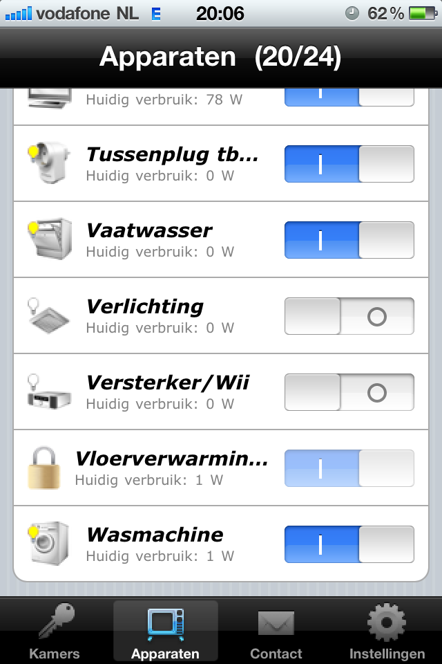

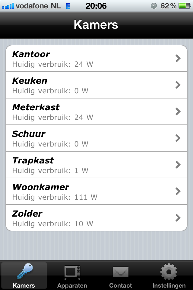

Today when i was browsing the app store like i always do and i found a app that we have waited for:
Plugwise for iphone
http://itunes.apple.com/nl/app/plugwise ... 93626?mt=8
U need to download a api folder and put it into your www folder to make it work.
More info can be found here:
http://myplugwise.com/iphone/
Only thing i would rather have is groups instead of rooms, but for the rest its ok.
U can get the lock (disable switching of manually) by holding down the appliance, then it wil get locked.

Re: iPhone interface for Plugwise
Yes, that Plugin works nice.
Thanks to the detectivework from PietjeNL. Traced on the day of publishing in the App-Store.
Hint: Copy the complete API-directory (with the 3 files) complete in the directory Program Files/Plugwise/Plugwise Source/www
So the new dir (containing 3 files) is called: Program Files/Plugwise/Plugwise Source/www/api
Regards, Verkenner
