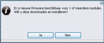

Source detects an update:

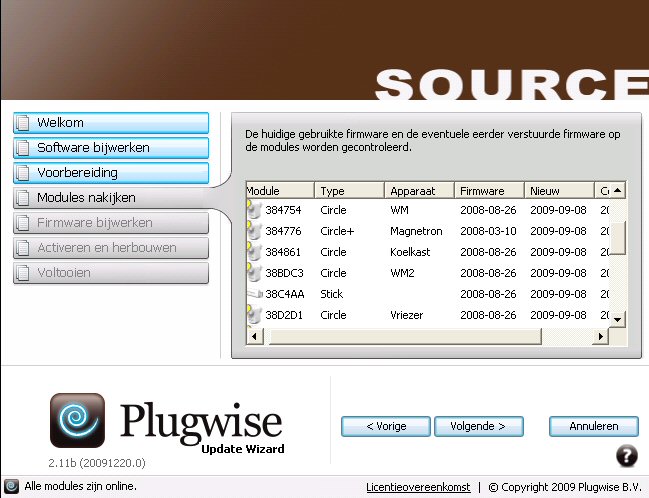

Displays the current version and new version:
3_PW_Available Versions.jpg (72.15 KiB) Viewed 22727 times

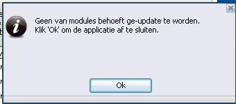

And then the updater, in all it's wisdom, decides there is no update required:
Not sure what's next, I guess just wait for the next Beta....

First update your (beta) Source to the latest Plugwise Source 2.12 Release 20091224
Than rerun the update en the firmware update should work (if you are a beta firmware user).
