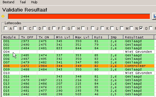

Doing a test with the PMIX does not reveal any weird things on this module:
Screen shot 2009-12-25 at 17.13.15 .png (123.5 KiB) Viewed 4400 times
Before I pull out the module and have it replaced, is there anybody who has an idea what could trigger this?
