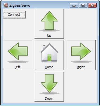

Next item was a small program that would use the API to address the XBee module.
4 buttons for Left, Rigth, Up and Down, a Home button and a button to connect to the Zigbee network. Not very spectacular, I’d say.

The code that is executed when the “Connect” button is pressed, sends out a Node Discovery command. This will trigger all joined Zigbee modules to respond with information about themselves, like 16- and 64-bit address, node identifier and some more interesting stuff. The code goes something like this:
  XB:=TXBEE.Create(14,9600);
  XB.Open;
  gXBeeModules.Clear;
  cmd:=TXBee_NodeDiscover.Create('');
  XB.SendPacket(cmd.GetPacket);
The Node Identifier is used to see if the Zigbee module that is connected to the Arduino, is “in the air”. Cause it doesn’t have to be, it could be disconnected from power or whatever…
When the Zigbee module with Node Identifier “”ED5″ has responded, the 5 buttons are enabled and clicking them will move the servo’s. This is done with the XBee Transmit Request function; a string is being sent to the XBee and the XBee will take care of transferring it out on the UART. Below the code for the “Home” button:
