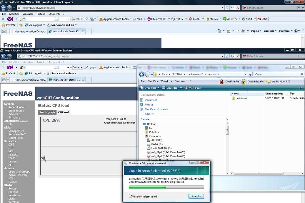

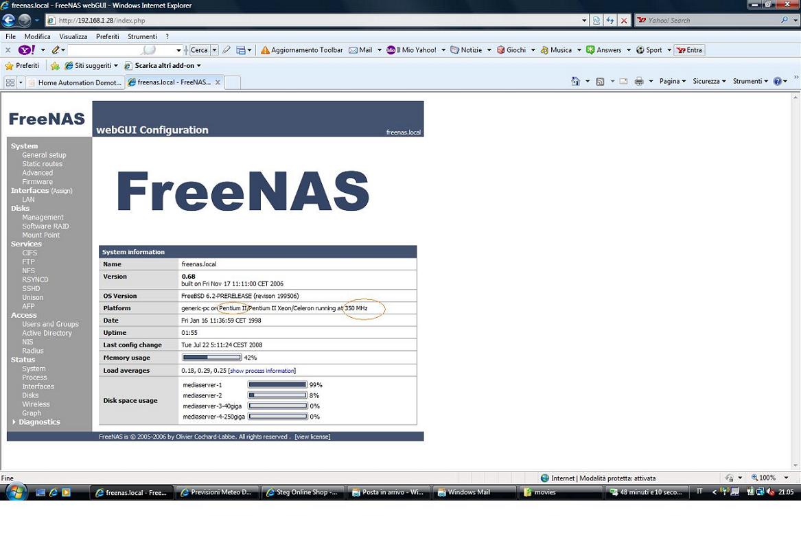

SEE System screenshot
SEE CPU load on copy of more than 5 gigas
