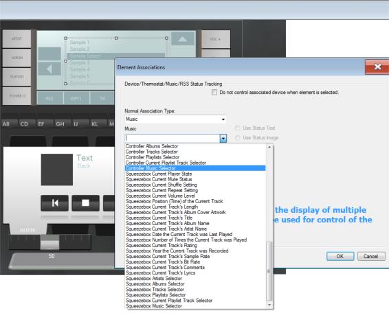

Updated last week, still a beta but a very promissing one!
The pro's :
- HS Touch integration, it is possible to do music selection and browse the my music collection
- It's fast, I have about 30.000 songs but browsing is and changin selection is still possible
- Full music API integration, selectable from the HSTouch designer, no more "virtual device tricks"
- Quite stable for a beta
The con's:
- I have two players, Homeseer sees both but HS touch only shows one. Seems to be a HS problem.
- Memory, i have experienced a "out of memory error", seen this also with the iTunes plugin. Looks like yet another HS problem
- Small bugs, eg. it cannot not handle special characters (Michael Buble works, Michael Bublé doesn't)

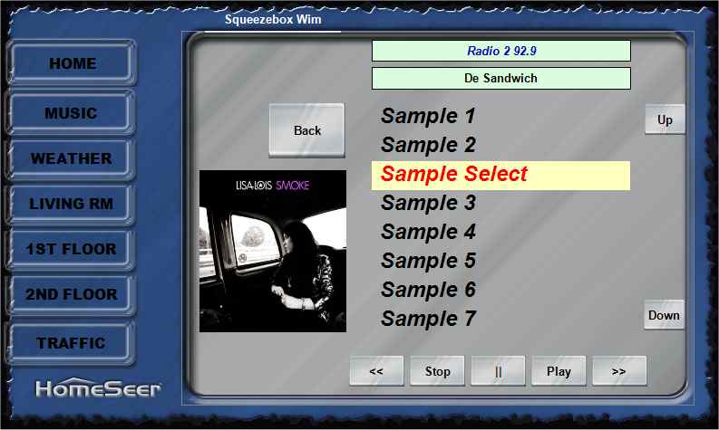

Here i am expieriencing some trouble that i can solve ( same as marcus at hs forum )
just need some time for that... but if it works it works very nice.
The way It works in designer is almost the same as the mediaplayer or itunes plugin, the way you build i mean.
I simply modified my mediaplayer plugin page wich runs good as long the numbers of my players dont change.
but i guess you get a good impression in this picture what music options you get for eachplayer..

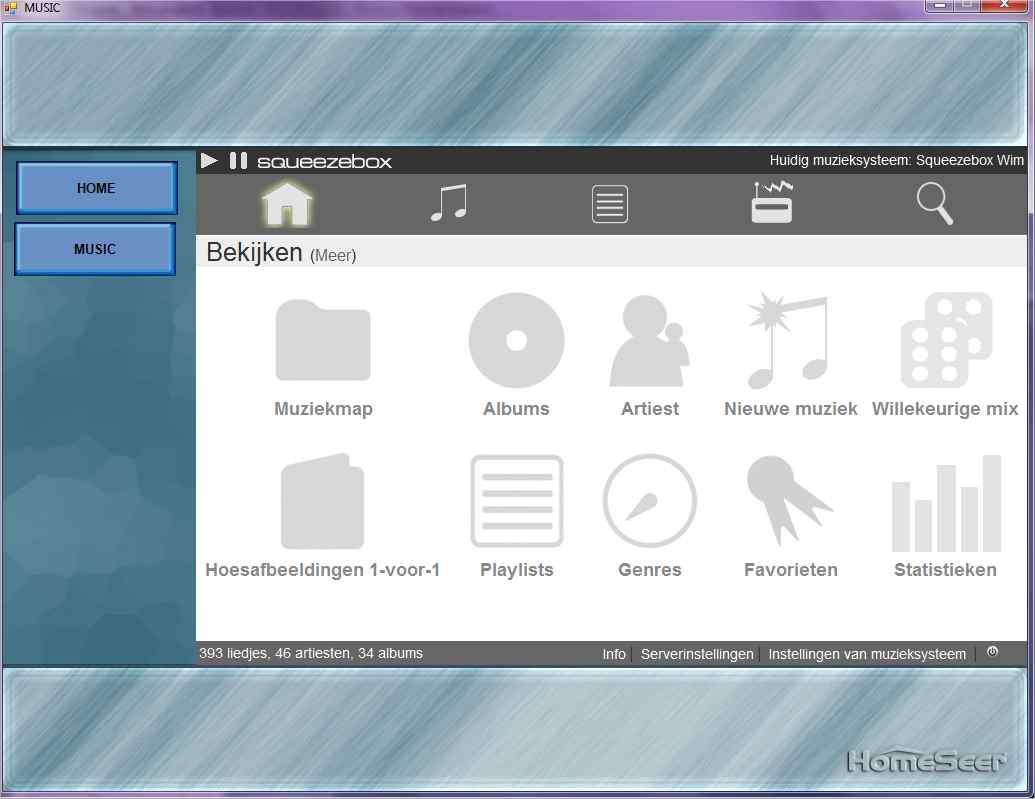

Below I have attached a example of a screen what I created this afternoon in HStouch. You are also saying, it will not work well. Can you say when or why?
If I change the call HTTP://YOURSERVERIP:9000 into HTTP://YOURSERVERIP:900, I got the same screen. What tells the 9000 or 900?

That's the port number. It's used to connect to in combination with the ip address. An application on a server can be programmed to listen on a port to receive traffic from other hosts. 9000 is the default port for Sqeezebox Server.What tells the 9000 or 900?
Alexander
Re: Squeezebox plugin v2 supports hstouch
Wim,Wim2008 wrote:. You are also saying, it will not work well. Can you say when or why?
B.R. Wim![]()
I did get the same screen but nothing happend when I used the buttons. My Squeezeboxserver is always on, it's running on a Windows Homeserver. So if it works in your system, something might be wrong with mine.... I'm now using the standard Squeezebox skin, that works well.
Dick
