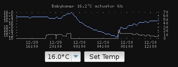

http://www.martin-haas.de/fhz/screenshots.html
The fhem can generate various log files and let these values so you can use on your site.
I also made for my own site a plugin to set the temperature
Also see that the actuator for the 2 min s ong and you only 1x per 15 min measured temp gets back
2009-12-18_14:37:27 bkamer desired-temp: 15.5
2009-12-18_14:38:00 bkamer actuator: 18%
2009-12-18_14:38:01 bkamer measured-temp: 15.0 (Celsius)
2009-12-18_14:39:57 bkamer actuator: 26%
2009-12-18_14:41:53 bkamer actuator: 26%
2009-12-18_14:43:50 bkamer actuator: 34%
2009-12-18_14:45:46 bkamer actuator: 34%
2009-12-18_14:47:43 bkamer actuator: 39%
2009-12-18_14:49:39 bkamer actuator: 41%
2009-12-18_14:51:35 bkamer actuator: 43%
2009-12-18_14:53:32 bkamer actuator: 45%
2009-12-18_14:53:33 bkamer measured-temp: 15.1 (Celsius)
2009-12-18_14:55:28 bkamer actuator: 47%
2009-12-18_14:57:25 bkamer actuator: 49%
2009-12-18_14:59:22 bkamer actuator: 49%
2009-12-18_15:01:18 bkamer actuator: 51%
2009-12-18_15:03:14 bkamer actuator: 51%
2009-12-18_15:05:11 bkamer actuator: 51%
2009-12-18_15:05:12 bkamer measured-temp: 15.2 (Celsius)
