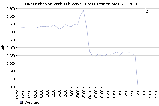

First of all, I implemented Homeseer on a HP NC6220 notebook and now my "meterkast apparatuur" power usage has declined about 45 percent. See chart.... It's about 75 watt less, so for a 24 hour "on' device this is a rather good step in the right direction.
For the jacuzzi I ordered a Kwh meter on a rail with a led indicator, which I can measure with the RFXpulse device. So I can see what the Jacuzzi is using.....
So I'll keep you posted about the progress,
