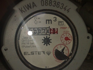

The water meter does have a half-wheel that is reflective:
Will that work?
Thanks,
Jos

Jos,
Yes, you can use the reflective optical sensor on the Elster water meter.
Bert
