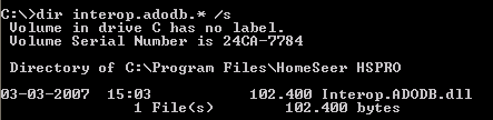

But, same issue occured, homeseer crashes after an incoming phonecall.
The main homeseer log reports:
26-1-2010 10:37:52 ~!~Web Server~!~Web Server stopped
26-1-2010 10:37:52 ~!~Warning~!~Error sending UPNP announcement: De thread is afgebroken.
2 minutes later, windows reboots.
Unfortunately I cannot find your email address and I'm not allowed (yet) to PM you.

Maurice,
Could you please check if you have this file?
mo046
Posts: 186
Re: Version 0.6.1.0
Post by mo046 »
Robert,
I don't have interop.adodb.dll in the Homeseer program directory, but it is being used by the RFXChart plugin. I've copied that file into the homeseer folder. Now everything seems to work with your latest version of the FBF plugin. Incoming call is working with lookup result from FBF internal phonebook.
However, now it seems that the plugin is causing homeseer to use up all CPU load. I've disabled the plugin (renamed HSPI_FBF.dll and restarted Homeseer). Now CPU load is back to normal.
** Maurice **
