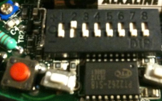

Remote dipswitches:
The curtain does not respond if I use code C1, and I even tried H16 incase I configured it wrongly (both housecodes set to full control). It also does not respond when using RFtransmitter.

Transmitter 41 is a RFXmitter so you have to use RFXmitter.exe
http://www.rfxcom.com/documents/RFXmitter.zip
Which Harrison motor type is used, 1, 2 or 3?
http://www.rfxcom.com/documents/Harrison%20config.pdf

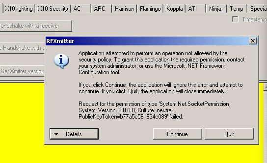

RFXmitter works, but not from my Hometroller (XPembedded).
I turned on the RFXmitter setting in HS and now it works... just 1 quirk...
