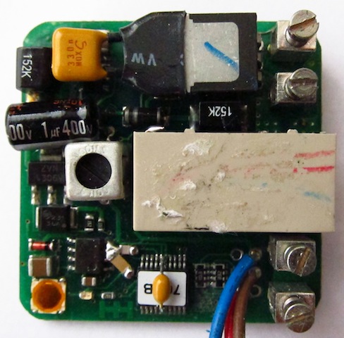

Broke a Xanura SAIX module or a Marmitek AWM2 module? And 'no user serviceable parts inside' doesn't stop you? Then crack it open and repair it yourself: These modules too have a fuse inside, but you need a soldering iron to replace it because it's just a piece of thin (fuse) wire. Make sure to replace it with equally thin fure wire!
Here's a close-up of the fuse:
Here's where to look for it:
(Note: The AMW2 module doens't have the TRAIC that's floating above it populated)

The internals of the module look like this:
Internals of a SAIX module
Module internals.JPG (78.14 KiB) Viewed 21186 times
The discolored area of the casing covers the top-left quadrant. In this area, there's a capacitor of 1uF/400v. This capacitor is a vital part of the module's power supply and it's a well known fact that capacitor dry out when exposed to heat for a long time. Tere have also been reports of poor batches supplied by manufacturers.

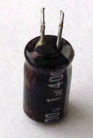

A closed inspection of the bottom of the capacitor shows that it has been leaking some electrolyte:
Capacitor bottom.JPG (45.65 KiB) Viewed 21186 times

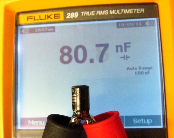

Verifying the capacitor's actual capacity confirms it being defective:
Capacitor degraded capacity
Capacitor capacity.JPG (71.21 KiB) Viewed 21186 times
Where it's capacity should be 1000nF, all that is left is 80nF.

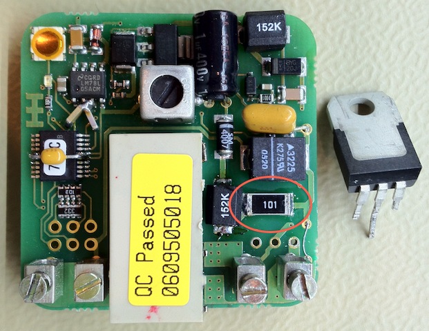

If your module is broken and the capacitor looks fine, you might want to check the series resistor (circled in red) of it's internal power supply. It's an 100 Ohm resistor, SMT package 2512 of 1 or 1.5 Watt (http://nl.farnell.com/jsp/search/produc ... ku=1887761). It's located under the TO-220 triac:
Internal power supply series resistor
You can bend up the triac, but that's not recommended because the pins will easily break. Unfortunately removing it isn't very easy either, because one of the leads has been bent flat to thicken one of the PCB traces. But if you accidentally break the triac, you don't really have to replace it, as the module will work fine without it. It's a little helper to the relay, preventing sparks on the contacts, uprating it from 10A to 16A. If you don't attach such heavy loads, your module is fine without it. Marmitek brand modules don't even have this component placed.
If the resistor is the problem, I always recommend you to replace the capacitor anyway: It's a small extra effort when the unit is opened up on your workbench.

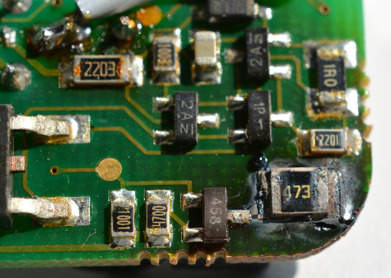

Another Xanura SAIX bites the dust. I noticed the module squeeling louder than usual and no lamp was mounted on the junction box, so I noticed the LED blinking erratically. The module was warm too, it's plastic housing showed brown discolouring and signs of melting. So without checking if the device still worked, I removed it from my installation and opened it up:
Xanura SAIX running hot
Xanura SAIX running hot.jpg (173.34 KiB) Viewed 21061 times
I checked the capacitor, the series resistor and even the fuse I described above, but all checked out ok. The resistor marked 473 got a little hot (duhuh) and out-of-circuit it measures 35kOhm, where it should be 47kOhm. That's 24% less than it's rated value, but I think this more of an effect than a cause.
Does anybody encounter a similar defect, or have an idea of what's wrong with this module?
