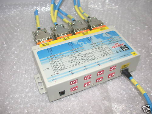

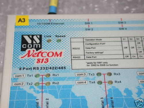

I like Vscom
I have a VSCOM 8 x RS232 to USB for nearby stuff
And I just bought a 8 x RS232 to TCPIP on ebay thanks to you :) for 100 dollar incl shipping
I now have 2 x 2 x RS232 to TCPIP from AXIS I will replace these with the VSCOM.
VSCOM is a good product, also very low on power consumption!
I Dont like the USB to TCPIP yet, they have a lot of troubles...
There are some more topics about these devices on the forum
My new VSCOM
My new VSCOM
Regards Pieter

Nice to hear. Which model is it (lite or pro?)

No Pro, to heavy for my place :)
http://www.usbgear.com/NETCOM-813.html
Netcom 813
Netcom 813

Problem is when your peripheral is an usb one. Nice the 8-rs232 over tcp ! what are the 8 (!) serial devices connected? Ciao , Lorenzo

I have multiple rs232 to ip devices (AXIS 2 x rs232 ports, for sale soon :) )
I will replace the axis with 8 x RS232 to IP VSCOM in the fusebox closet.
Btw: I don't use any drivers for this device, I connect directly on IP base from the Bwired software. (I hate all those drivers )
Connected to my server I use the 8 x RS232 to USB VSCOM, this is for devices I need to see like weatherstation etc.
I Still like RS232 the best :D

Does the VSCOM support multiple TCP connections to a single port? Very welcome feature for development.
Then i would buy one right away :)
I have 2 x Sollae EZL-200F which support max 8 concurrent TCP connections.
Those devices work flawlessly BTW, never any problem.
Same good performance here with the EZL-400S, 4 x RS232.
There's also a CSE-H20 with 2 x RS-232 for the same price. No experience.
Using drivers is something i always try to avoid too; using direct TCP connections is much more flexible. But it mostly depends on the software you're using if you can live without them...
Re: All connections over IP
Digit wrote:Pieter,
:D Yes multiple connection possible with the settings of "Max Clients" for every port.
