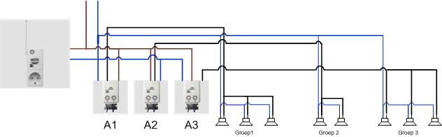

Hi guys,
I'm in the last phase of completimng a 8 monthn long rebuild of our new house.
The first room to complete will be the attic, which will be the master bedroom.
I created 3 groups of ceiling spots and I want to control these with x10.
I created a technical space in one corner of the attic, where the 3 black switch?-wires of the 3 lightgroups end up.
In this corner I placed 3 LM12W dimming modules and a LM13 tranceiver module. I want to control the lights with 2 SS13 flat wall-switches (one against the wall, one near our bed)
This is how I thought I should wire it (zie attachment):
Eric
Bedradingschema zolderverlichting
schakelen zolderverlichting.jpg (15.17 KiB) Viewed 2959 times
The problem is that none of the groups work when I try to swtch them on with the SS13... I tried attaching a regular lightbulb, but nothing....
The LM13 does work on code A1, so there is nothing wrong with the SS13
PLZ help!

Eric,
theoretically it must work is described.
Only problem can be the noise on your power-line.
