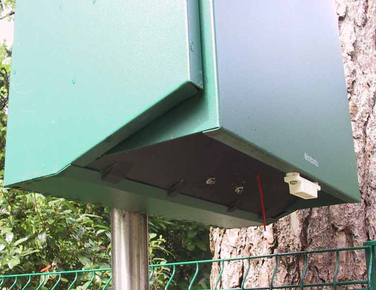

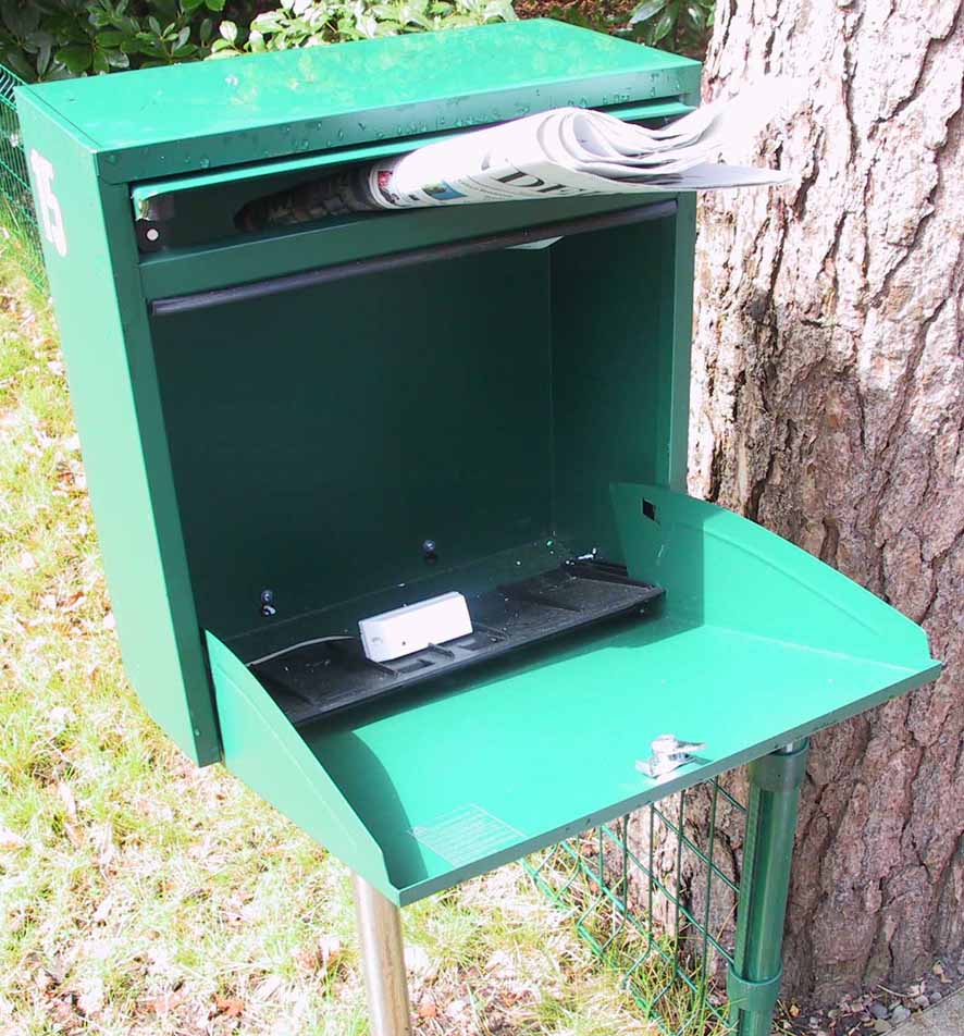

I have the same postbox located down my driveway and found a good solution.
In the attached pictures you can see that I have mounted a Visonic MCT-302 at the bottom of the box.
The bottom is made of plastic whilst the box is of steel sheet material. The MCT-302 is mounted on its side with the internal readcontact against the Postbox bottom.
At the lower end of the front panel of the postbox I attached the sensor magnet, it will hinge against the MCT-302 when the panel is opened operating the internal readcontact.
I connected the second MCT-302 external contact to a readcontact on the shutter of the mailbox.
The internal antenne is replaced by an external (red) wire hanging through the bottom of the mailbox.
A virtual device in HS will trace wether there is mail in the box or not controlled by the MCT-302 events.
Saskia of Linquendo will anounce the arrival of the mail through HS-Speaker and a RFXio port will leave a visible indication by lighting a led.

As I would like to do the same to my mailbox I still have a question.
How can you replace the internal antenna of the MCT-302 by the external wire?
My mailbox is completely made of steel and therefore need to get the signal outside somehow.
I will get the MCT-302 next week and the drawing shown on the Visonic Installation Instructions is not clear on that.
A picture and wiring instruction is much appreciated.
