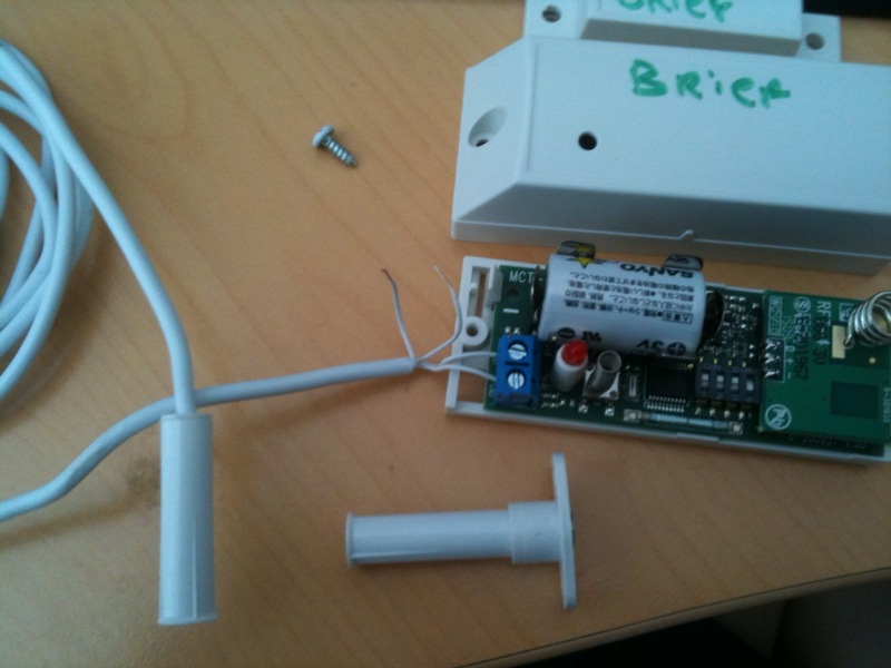

So the mct-302 works like a charm, so now i wanted to add that external contact.. but why does it have 4 wires? am i missing something here?
I ordered this some time ago (really long time ago) so i can only remember that i got it from waakzaamwonen, as the contact that is suppose to go with the mct-302.
Anyway, a picture says more always..
Cant see any text on the 4 wires, so dunno which ones to take.. anyone else has this too?

If I remember correctly the MCT302 external contact input can be configured for NC and NO. So with a multimeter you should measures what the behaviour of your external contact is in relation to the wires and then you which wires you should pick.

I think you need a resistor too,
The other two wires are for security, normally they always need to be connected. if they are cut you can trigger an alarm.
You don't need them I guess.
Keep in mind that only one of the outputs has status update every 15 minutes, you can also weld it to the glass switch.
All depends on where you are going to use it for?

I only use 2 wires for the magnetic contact.

I got the same external ones from waakzaamwonen, in my case they where twisted 2 by 2 and just connected them straight without a resistor. Not at home, but when I can take look if it's apparent how it's twisted together....

well i got my battery for my multimeter, so i got the correct wires. then just changed the dip switches and all is working.
