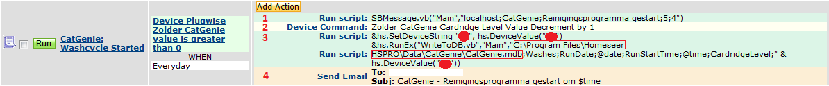

7. Create the Washcycle started event based on the picture.
Notes: Action 1 --> only configure this when you have a Squeezebox and want to display a message that the cycle has started (for details about the setup of the squeezebox messaging review my other tutorial at --> http://www.domoticaforum.eu/viewtopic.php?f=47&t=3716)
Action 2 --> This actually makes sure that the cardridgelevel (virtual device) go down as cycles are run
Action 3 --> Writes a record to the CarGenie.mdb database noting the starttime of the cyclerun and the cardridgelevel that belongs to it.
Action 4 --> Send an email which tells you that the cycle has started and at what time (I use this to check if everything is working as it should. Later on this will be viewable from the web using the database in step 3)
Make sure that you fill in the virtual device id at the red dots.
Make sure that the path to the CatGenie.mdb is pointing to the right location (where you saved it earlier)
CatGenie - Washcycle started.png (19.7 KiB) Viewed 18305 times

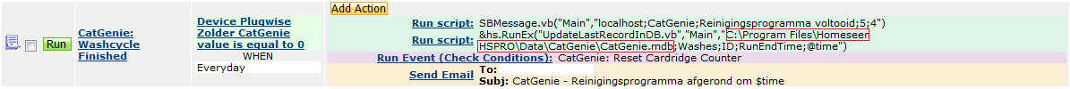

9. Add finish time to the database as the cycle is finished email the results and check if the cardridge counter has to be reset (condition). Create the event like the picture.
Notes: Make sure the path to the CatGenie.mdb is set correctly (highlighted by the red square).
The emailaction is obviously optional as explained earlier.
The condition value of the reset cardridge counter action is --> Device: "<catgenie plugwise>" Value is: "Equal to" Value: "0"
The reset cardridge counter can be set safely because the CG will not work when the cardridge is empty. Reseting the value will therefor always work correctly.
CatGenie - Wascycle finished.png (16.45 KiB) Viewed 18305 times

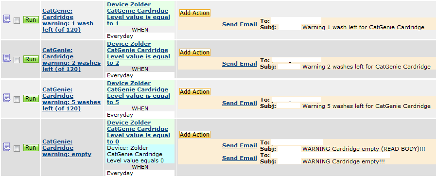

10. Create the "cardridge almost empty" warning events. I've created several at different cardridge levels. Basically I email the warnings as they are not critical. Only when it's empty I will get a instant notification. Create the events you want according to the events in the picture.
CatGenie - Cardridge level warnings.png (39.5 KiB) Viewed 18305 times

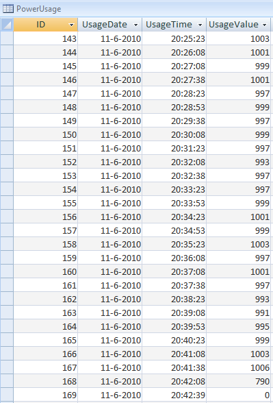

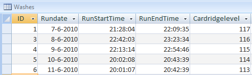

Here is an example of added records in the CatGenie.mdb:
CatGenie - CatGenie.mdb example.png (9.35 KiB) Viewed 18304 times
Here is an example of added records in the CatGeniePowerUsage.mdb:
CatGenie - CatGeniePowerUsage.mdb example.png (27.85 KiB) Viewed 18304 times

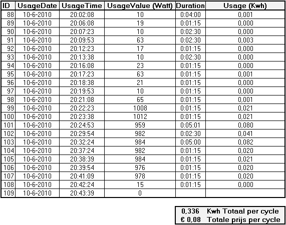

Here is a analyse of one of the runs I did just for the fun of it. I took the records from the CatGeniePowerUsage database, converted the usage to Kwh and calculated the total usage which I converted to a price (using €0,25/Kwh). When crunching the numbers and comparing them to the Plugwise recordings, they match :D
CatGenie Cycle Usage.jpg (128.97 KiB) Viewed 18304 times
