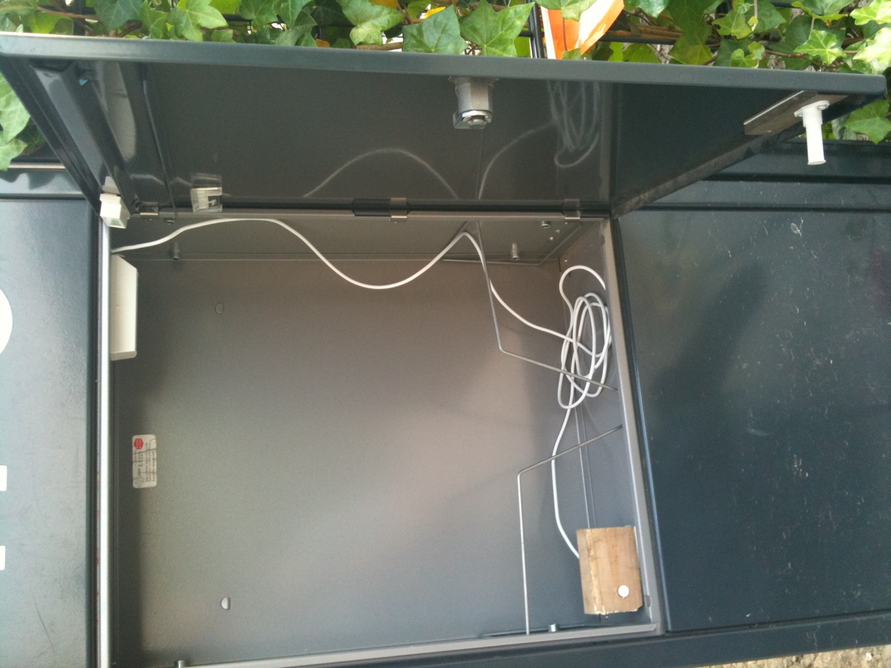

Since my mailbox was not done yet, i decided to test it out too.. :) with a visonic..
Dirty quick way though...
But now the bad part.. it works.. i tested the sensors and all. But then i close the mailbox, and it works 50/50 most of the time. Basicly because its a all metal mailbox it doesn't like it :(
Anybody has a idea on how to solve something like this? Or do you know if i can re-attach the antenna of the mct-sensor to a more "outside" place via a cable of some sort?

That's a problem
You can try to extend the antenna with a little wire outside the mailbox
Or place the Visonic outside the mailbox where it can not be seen.
