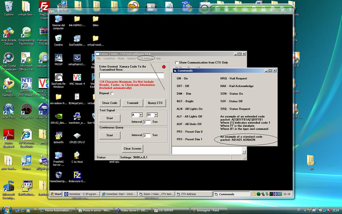

If you are using the test tool from Holec Eaton , you can not only check transmission but even turn on/off devices , go HELP/COMMANDS and see example.
did you try to start devices by this way?

L1 is the address of your device ? i use x10 device and in the image you see the command to turn on a x10 lamp on A1.
about ctx-address (see image again) i use ADDRESS ZERO (there are many options)

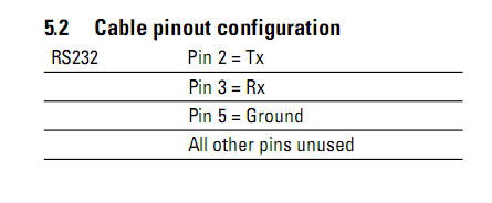

Re: how to connect & test CTX35
2 <-> 3
3 <-> 2
5 <-> 5
ctx35 rs232 pinout
ctx35 rs232 pinout
ctx35 rs232.jpg (39.73 KiB) Viewed 10361 times

confused about cable. drmacchi says straight, bwired seems like crossed.

Always use straight cable with CTX35. All wires in cable should be connected. So 1-1, 2-2, 3-3 etc.
I see on your screendump that you are trying to use testtool and Homeseer at the same time. When homeseer is configured to
work on COM1 for the CTX, then this will not work. Always close all programs that are using the comport you are testing.
Check for other program's running on the background that maybe use the comport (for example touchscreendrivers, 1-wire drivers etc).
CTX can be configured in two speeds, 9600 or 19200, Check these settings in testtool.
Good Luck!
Menno could be right about this, I did not actually check the cable, but normally its crossed so I assumed. :o

I do confirm that cable is straight. with crossover it doesn't work. then if you are running HS , and at same time launch test tool , it gives you a warning that COM PORT IS ALREADY IN USE.
