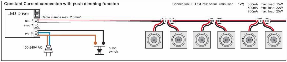

We have a dimmeble led driver witch you can control by a simple wall switch ( pulse switch) , this solution we have used several times.
This is even very simple with more then 1 switch combined in parallel settings.
Now we want to connect the some solution as mentioned above , only within a pulse switch from x10 or zwave.
Would this be possible , and how would this possible ..?
see technical drawing or products sheet for more information
mood-ledlight.nl/pdf-productspecs/ART-L ... dimmer.pdf

The best way to control this driver from a Domotica side is by using the 1-10v input, the main problem with all the other solutions will be timing, in other words there cannot be any delay between when you start pressing the button and whe you release it. (CORRECT ME IF i'M WRONG GUYS)
With the 1-10V solution you can be explicit, I want the light to be at 60%, which is what you want with Domotica.
Regards, Maarten.
