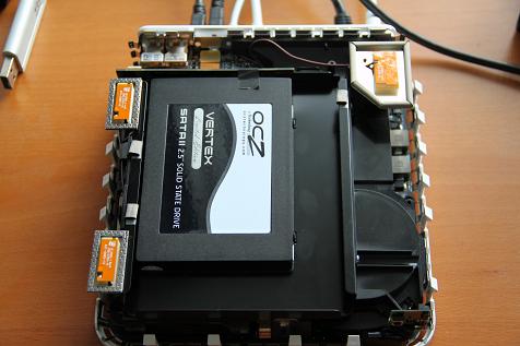

I replaced 1 of the hard disks with a OCZ Vertex Limited Edition (See photo)
I installed Windows 2008 R2 Server 64bits
I'm running a resolution of 2560x1600 on a dual-link DVI display using Mini DisplayPort to Dual-Link DVI Adapter connected to a Dell 30inch
So I'm switching for some software to 64 bits (like MYSQL etc)
Also IIS7.x
Thats why it takes some more time to test, have to be sure it runs smoothly.
Until now I'm very pleased with the Mac Mini, unbelievable performance together with SSD
W2K8 is starting up under 15 seconds.
So I Think a couple of weeks and I'm done and running on the MAC.
Amazing energy reduction also, the MAC on W2k8 together with active DVI adapter is taking around 18 watt Idle.
