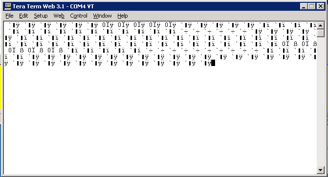

I am trying to find a solution to readout the device.
On this moment i will receive RAW data from the device (for example, when i press on a button of my KAKU remote), see attached screenshot. This data I also receive with my PHP scripts but it isn't usable on this moment. How can i decode this `crap` to readable data?
The com-port settings are the same as i use with the RFXreceive tool from RFXcom (there the data is readable).
RAW RFXcom data
RAW RFXcom data

Keep in mind that the raw data is binary data, so it doesn't make sense to look at the data using an ascii terminal application.
The RFReceive utility has 2 modes, in one it displays the raw hex data, the other mode will show you the decoded data.

Re: Decode RFXcom signals
Post by Webtijn »
I've also tried to read out data from the rfxcom in PHP. The problem is that PHP isn't a propriate language for this stuff. You might want to look at the PHP funtions bin2hex and pack/unpack. Keep me posted!
