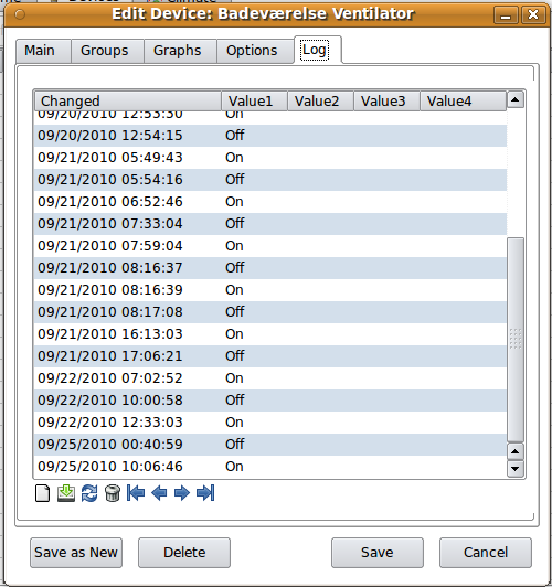

To help me keep an overview of what is going on in my system, I have added a table to log value changes of devices. And to see the log, a new tab to Edit Device:
It's a work in progress. I'm not entirely satisfied with the functionality of this log display, and not sure it's the right place to monitor device changes. But the log was very handy when I was debugging my event set-up, so I thought I would share it now.

I have kept your device log window in the device editor, for editing/deleting/quick look.
It's just small browserdata stuff anyway.

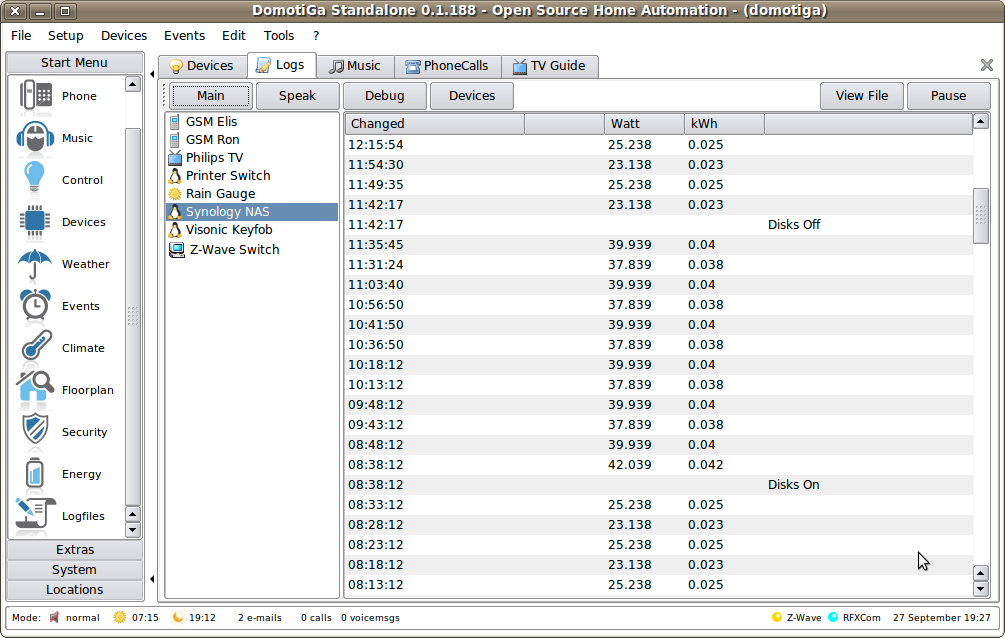

But I also added a window to the logs page, here it shows all devices with log enabled, and the values are calibrated/divided.
See screenshot below.
