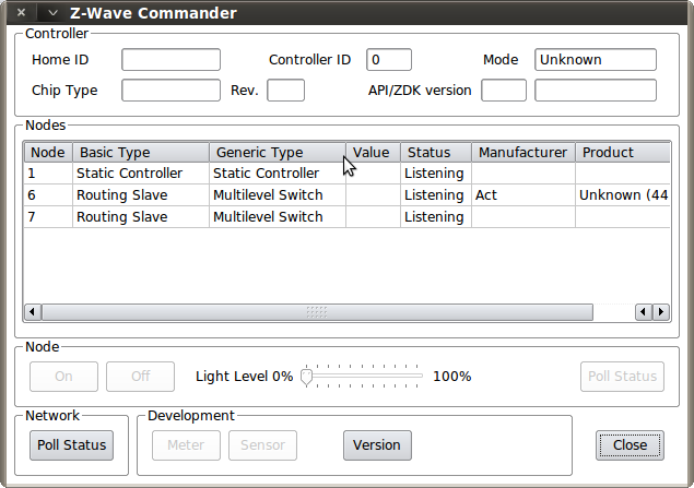

Re: Aeon Labs Z-Stick Series 2
I'm having the same problem, but my controller is connected to the right port (/dev/ttyUSB4)
I'm able to control my z-wave devices, but local changes is not updated in Domotiga.
[ 30.371118] usb 2-6: cp210x converter now attached to ttyUSB4
So it fetches the dongles learned device table, it switches but status isn't coming back, correct?
Can you mail me the debug output of ZWave module?
I guess there is a serial code/timing problem.
Since I have learned a better way to write and read data, I will try to implement that for ZWave too.
I'm also thinking about using the open-zwave library instead to talk to the hw.

COMMAND_CLASS_ASSOCIATION
COMMAND_CLASS_POWERLEVEL
COMMAND_CLASS_CONFIGURATION
COMMAND_CLASS_VERSION
COMMAND_CLASS_MANUFACTURER_SPECIFIC
COMMAND_CLASS_MARK
COMMAND_CLASS_BASIC
COMMAND_CLASS_SWITCH_MULTILEVEL
COMMAND_CLASS_BASIC_WINDOW_COVERING
Act
Unknown (44 47)
