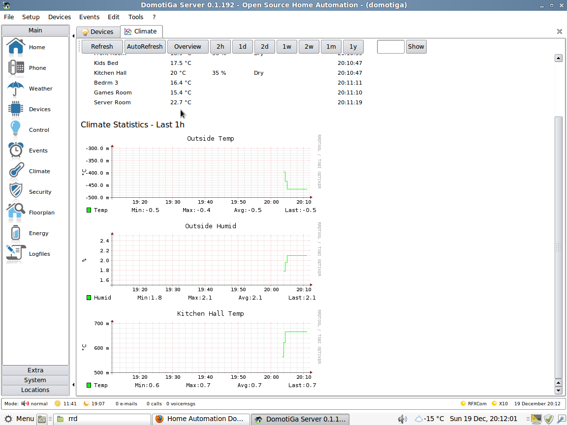

p.s. which datasource type is best? gauge? My graph units and axes look strange. Please see the attachment.

I disables quick graphs, set up the advanced ones and all is well with units etc.
Thanks for the help guys.
