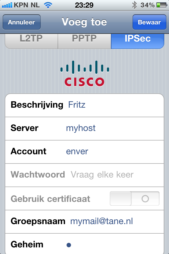

With some help of Edwin I can acces my fritzbox as VPN gateway.
This is working well with the freeware VPN client Shrew.
Since I also need Iphone acces i have modified the config file to make xauth possibile.
Using the build in VPN Cisco client I can access my network from the Iphone
Now the PC client is no longer working...
tried all the possibile options..
Also upload of second config file is not working since the first one is overritten when doing new upload...
I have also Cisco VPN client installed on my laptop but did not manage to make VPN connection using the PC client.
There are not so much options to configure...used the same options as the iphone...but no succes
VPN to Fritzbox
VPN to Fritzbox
