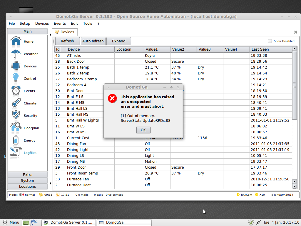

Here is one.....
I've turned off my server stats for now.
Thanks,
Andy

RDNZL
Posts: 1008
Re: Restarting DomotiGa automatically
Post by RDNZL »
Which Linux distro do you run?
How many memory does your machine have?
This is a system error, no resources left.
On Ubuntu Maverick I have some times a problem with RRD too, but then "too many open files"
Now all RRD calls are done with SHELL, which mean a complete shell environment is started for each command running.
I want to change it to use EXEC instead which should be a bit faster en lighter...
Regards, Ron.

Post by Andy_Burn »
The machine has 2Gig memory, running Linux Mint 10, fullly updated. Strange because I can do other things, the machine is not frozen.
I am logging Currentcost with it, which generates a call every few seconds, by quick graph - could it be this?. Also plotting outside temp/humidity and inside temp/humidity.
Thanks, Andy

Post by j.hoekstra »
Got the same thing every now and again, now it only produces this error or freezes every couple of days with rrd switched on. To me it seems gambas is eating memory as before I start gambas I got around 1200M free of 2 GB and up until error this has dropped to around 200 MB. Stopping Gambas drops this again.
I'll see if a later svn-checkout of gambas helps.

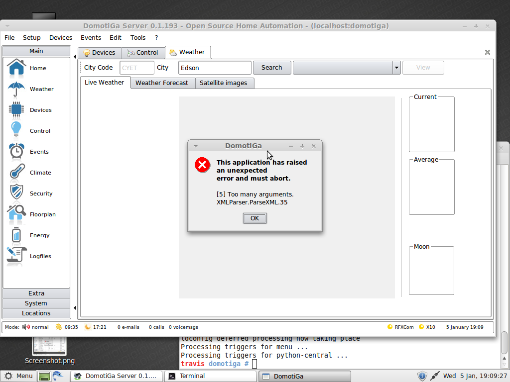

Heres another crash :( XML this time. mmmm.
Andy

Andy_Burn wrote:Heres another crash :( XML this time. mmmm.
Andy
This code is called by the TVGuide's code, there was something wrong with fetching the xml data from microsoft's site.
But the error display call had too many parameters, a bug that is fixed now in latest revision.
Thanks for reporting!
Regards, Ron.

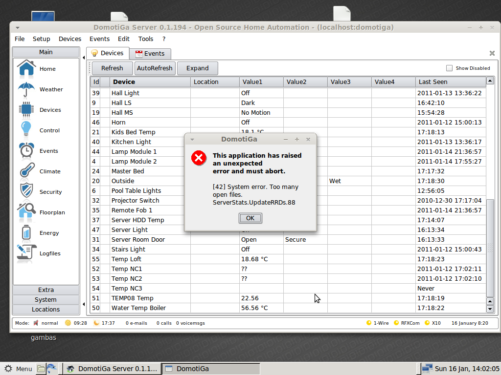

I thought my system was running fine. No problems really, since the new release 0.1.194
Then, my wife calls me at work to say the house is over 28C....
It looks like RRD doesnt like recording a lot of data... The gui crashed when the heating was on, causing a run away.
Im going to turn off RRDTool for now. Maybe, I'll run the server with a restart script. At least theres no gui to prevent it restarting if it crashes.
Andy
RRD error too many open files.

Can you increase max number of open files, to see if this helps?
$ sudo su -
# ulimit -a
core file size          (blocks, -c) 0
data seg size           (kbytes, -d) unlimited
scheduling priority             (-e) 20
file size               (blocks, -f) unlimited
pending signals                 (-i) 16382
max locked memory       (kbytes, -l) 64
max memory size         (kbytes, -m) unlimited
open files                      (-n) 1024
pipe size            (512 bytes, -p) 8
POSIX message queues     (bytes, -q) 819200
real-time priority              (-r) 0
stack size              (kbytes, -s) 8192
cpu time               (seconds, -t) unlimited
max user processes              (-u) unlimited
virtual memory          (kbytes, -v) unlimited
file locks                      (-x) unlimited
$ sudo su -
# ulimit -n 4096
# ulimit -a
open files                      (-n) 4096
Regards, Ron.
RDNZL
Posts: 1008
Post by RDNZL »
To check current # of open files in use.
Find your DomotiGa instance first, and then run lsof
$ ps -aux|grep gb
ron      18250  0.1  1.5  32108 16116 ?        S    09:05   0:05 /usr/local/bin/gbx2 -g -f /home/ron/domotiga/DomotiGa --
$ lsof |grep gbx2|wc -l
383
If you have the error on screen, do you many rrd processes running?
$ ps -aux|grep rrd
Regards, Ron.
