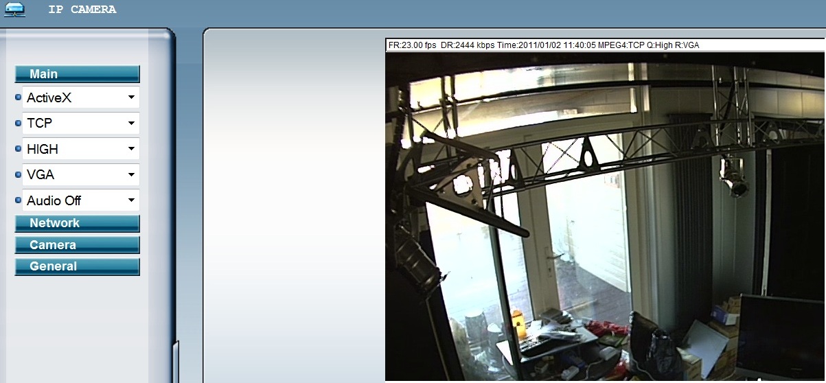

I have 3 IP cams AVTECH-AVI202, they work good when I connect to them through the web (http://xxx.xxx.xxx.xxx) and with a application I can view 4 in on 1 screen.
When I open the cam through explorer I have to accept a ActiveX control.
I like to use the camera´s with HomeSeer Pro, I tried a lot but I´m not able to configure them, I tried NETCAM, but then I need a URL to the camera.
I googled a lot and tried URL´s with thinks as snapshot.jpg but nothing worked.
See attachments for the screen of the cams webpage
I tried to read the source of the webpage, bt I can´t find any URL

In order to use a camera with NetCam or HStouch directly it needs to be able to output single images on demand (e.g. through a special URL). It could well be that your camera doesn't support this. It is a common problem with a lot of 'cheaper' Chinese/Taiwanese etc IP cameras, they're just not able to do that.
There are however programs that can capture the mjpeg stream of some cameras and then save an image for you. This however can be quite CPU intensive depending on how many cameras, resolution etc you have it process and it also makes the camera setup less self-sufficient. After a quick google search I came across the following software for example, which seems to support your model of camera:
http://www.deskshare.com/video-surveill ... tware.aspx
(note: I have no experience with this software)
One possible workaround:
You could have a look if there is some sort of FTP upload option available in the camera.
Camera -> FTP server upload to the HS html directory -> Use the HS html URL of that image in NetCam.
And have the camera FTP upload overwrite this image constantly or at regular intervals.
Good luck
