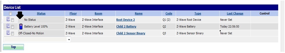

Today i got a brandnew sensor.
I started very hopefully BUT......nothing
A completely reinstall of homeseer.....nothing.....
Inclusion, no problem....but when i try the senor i don't get any respond.
It's driving me nuts !!!
Can there be something wrong with the Z-stick ?
I updated the firmware from the Aeon-labs website.
I noticed that the radiobutton at the left side of the "No Status" indication is missing as you can see where i drawed the black arrow.
Can somebody please help me out ?

Re: Everspring doorsensor configuring OFF delay
try rescan few times.
and wait for success.
if all your other zwave devices are working well than is you z-stick okay.
I did not hear any problem about this device and have sold enough to see problems if there are any.
Maybe a Monday morning batch.
I have it in use since june 2010 it's doing the work well.
see the review:
http://blog.tane.nl/?p=178
